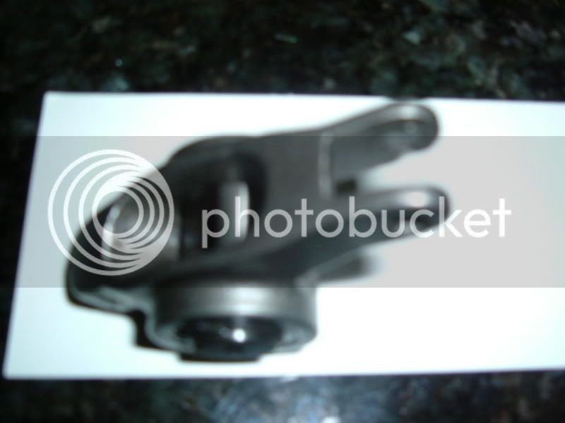

Here's a roller rocker off / for a push rod Ford..
There was only $50 difference between these and good quality Harland Sharp rockers.. Only trouble is I paid twice!! Live and learn !!!
Thank goodness I installed a magnet and screen in heads oil return !!
To prevent any contamination from valve gear..
