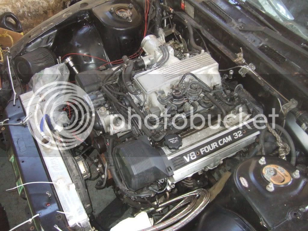

Current situation is that the engine is in the car, on some custom made mounts. The R154 is mated to the back of it, but through lack of room in the bay, we're just waiting on the hydraulic release bearing (as the clutch cylinders etc had to be removed from the bay). I'm also going to be running a pedal box, as it seemed the easiest way to solve the issues we faced.
As you can see, I don't have any manifolds yet. I'm in talks with a local company to get these created. Sadly, I'm building the car up to be the best it can be, but having to take a while due to montly budget constraints :)
A problem that will crop up eventually is that the sump is incredibly low. I've been thinking about dry sumping, and wondererd if anyone had any off-the-shelf solutions? I've been searching, but not turned up much (perhaps I'm wording my search wrong!)

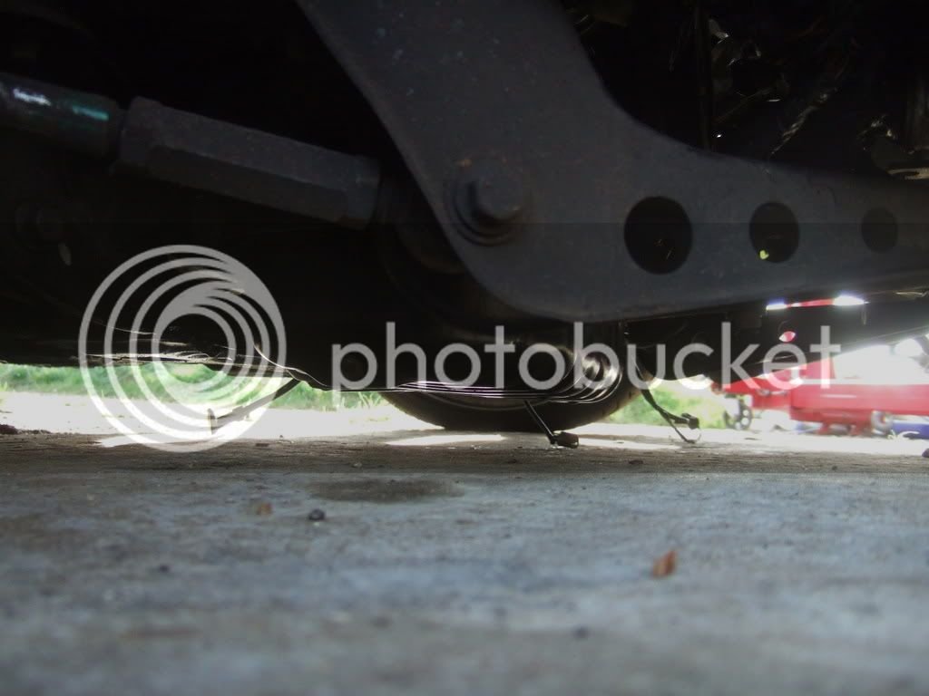

Yeah, a teammate stole it for his car. I've heard that Cefiro ones will fit around the engine, but will probably have to be modded too. Everything else has so far :)
good info! cefiro huh?..so are you driving without it? iis it ok?..i mean the feel.... any huge disadvantages? im doing the same thing its just that ive been really thinking about the swaybar issues><...either take it out completely or custom made? im not even sure if someone makes a custom swaybar for cheap?...hopefully theres a cefiro here in US..
I've not had a chance to drive it yet, waiting on a hydro release bearing for the clutch setup.
We've decided to hack the sump to bits and fabricate a new one, so will just get a S13 bar and hack that about too. Projects proving to be a complete pita, but will be worth it when screaming around track at 8000rpm :D
I made a new sump for my s13 swap.
And I just cut out the corner of the valve cover and welded it to make room for the brake-booster.

i've done the same conversion in my s13
i had the same problem with the sump sitting to low so i made up a bash plate and spaced it 20mm lower than the crossmember and have'nt damaged the sump yet(12 months and 30+ events later)
allso i cut and welded the sump to clear the 13 swaybar.
i run the normal clutch setup aswell
and i moved the brakebooster over 20mm to clear the rocker cover
if you have any questions feel free to ask.
