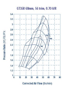

Personally I think the GT4088R is little too big for your 7.5 psi application. There is another version is GT4082R. However, I would suggest GT35R or slightly smaller.
I guess I missed the boat on reading compressor maps. For example, why is this map:
better than this map: (T61)
for the 2UZ?
What about this map: (T04B 60-1)
It looks like the 60-1 map would be more efficient for the 2UZ than the GT35R. But, I'm not sure. Any light anyone can put on this subject would be appreciated greatly.
Hillbilly:
400 HP is the max I want to push the 2UZ without some forged internals and bottom-end work.
He is actually dead on with the GT4088R if he want to maintain 7.5psi to readline.
The lbs/min rate on a 4.7L with 7.5 PSI is is going to be roughly 48lbs/min and with the exception of the T61, non will support that. Even the T61 is not a good choice cause in the top of the RPM range, the turbo will start to fall into an inefficient range, where as the GT4088R is still at about 70% efficiency in the top of the RPM range

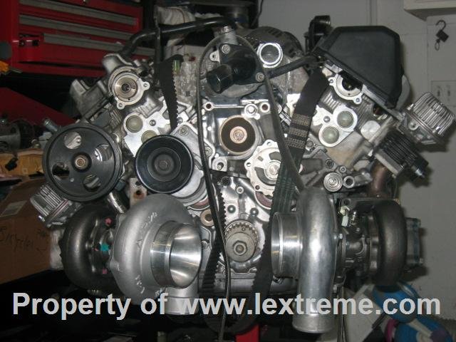

Thanks for signing up as a paid member. We really appreciate your support. I thin, MP is a great turbo. It is just like Garrett with half of the price. That 60-1 is pretty much prefect for the stock 4.7L application. It will max out around 550 rwhp. .63 A/R will be very good for street application. As for me, I will be using two of that similar turbos to the link above but with smaller A/R. Once again, go for it.....
