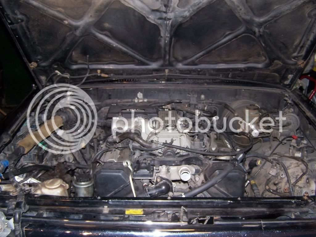

okay so I am doing a 1uz swap into my 4runner and the engine I am using has a ABS/traction contol computer wired to the ecu.... can you just remove the traction control or whats the scoop? their are a few wires to the ecu (engine) that control the sub throttle actuater. I need some direction if any of you have done this type of wiring to this system before- thanks in advance.
I have the rest of the wiring sorted out, all but this.
![100_0734.jpg 100_0734.jpg](https://www.lextreme.com/forums/data/attachments/14/14941-5e0b4a7efa43a11dba92194b9e6a0826.jpg?hash=XgtKfvpDoR)
