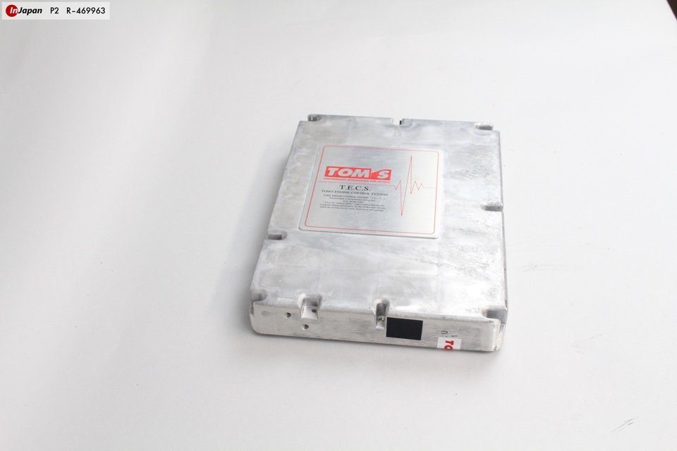

So I eventually got one. $350 delivered. Don't ask me how. I just happen to live in a country which gives you unlimited possibilities [to get things really screwed up, in most cases], but today it seems like a win.
ok, I got home with the box
opened it

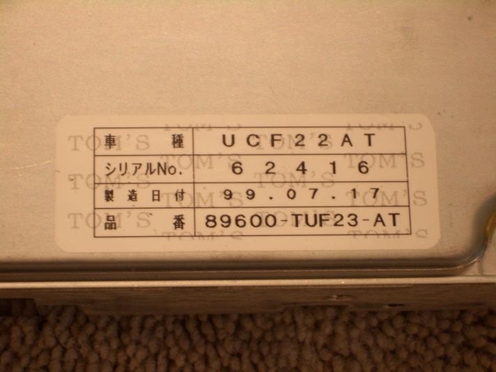

sticker on the ecu shows part number for order at Tom's
Connected it on table and, no big surprise, it has the immobilizer. And what's worse, the immobilizer chip is hidden under the add-on board. Which is mounted on 4 bolts and some sticky stuff. Only razor sharp Katana can undo it. ok, a decent box cutter works just as well. Undoing the add-on board and seeing the modified main board
