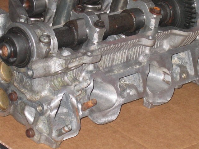

Here is my ported head, oversized valves, upgraded springs and stage II cams

Any pix of the under side of the heads?
Hey aren't those the heads off the engine you got from me aaaaaaaaallllll those years ago?

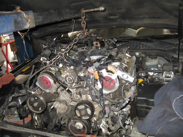

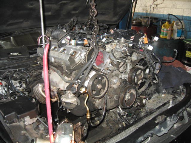

The mechanic is little behind schedule. However, here is a picture of the car with the engine being pulled out. Tomorrow is the day.....

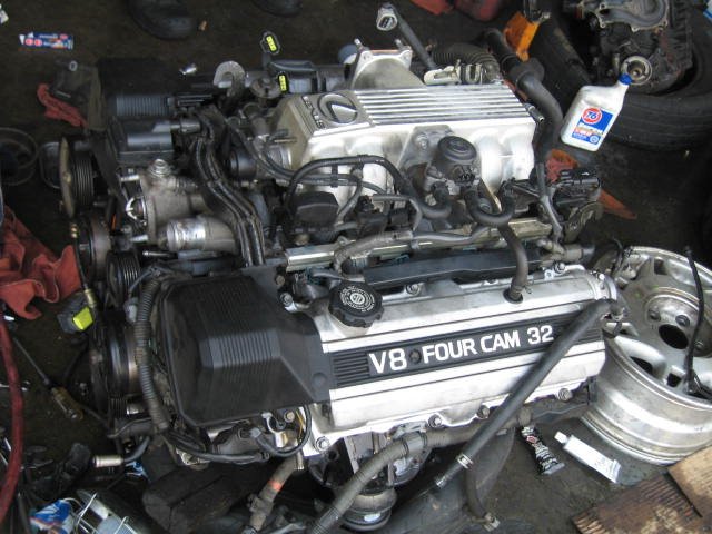

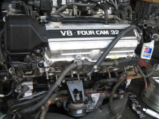

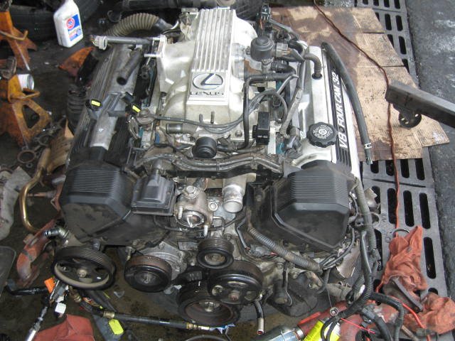

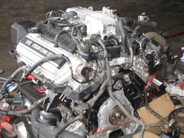

I stopped by the shop today and took some pictures for update. The engine is totally transferred to the new long block and ready for installation. Here are some pictures of the new engine looks just like stock from outside except the engine mounts.
