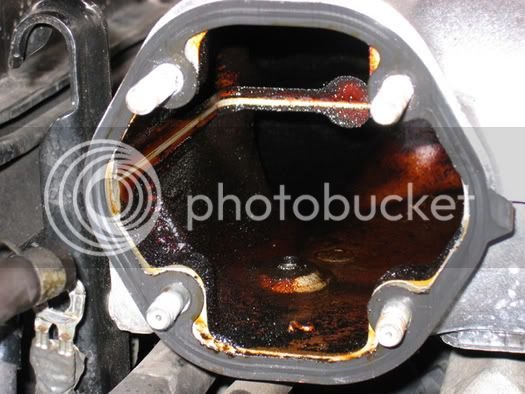

This is a 1999 1mz-fe v6, picture taking in 2003 of the upper intake air chamber (AKA the upper most intake manifold).
![ACIS-Build-up.jpg ACIS-Build-up.jpg](https://www.lextreme.com/forums/data/attachments/12/12758-ff68aba6284faa6ed18c46f52d0d2ef3.jpg?hash=_2irpihPqm)
That is only 4 years worth of normal driving.

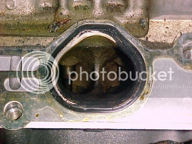

Intake port
