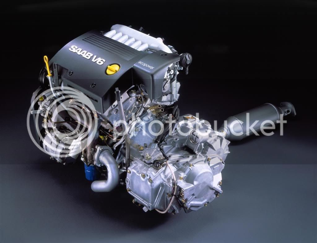

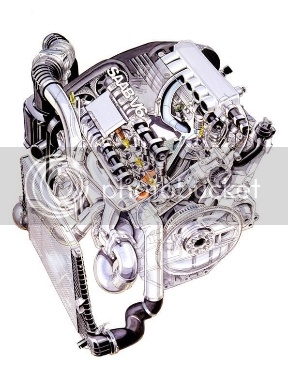

Saab built asymetrical turbocharged lpt V6 engines from 1999 thru 2003.
Here is the 1999-2003 Saab asymetrical V6 with only the front 3 exhaust ports powering the turbo to a max of 3.6 psi
