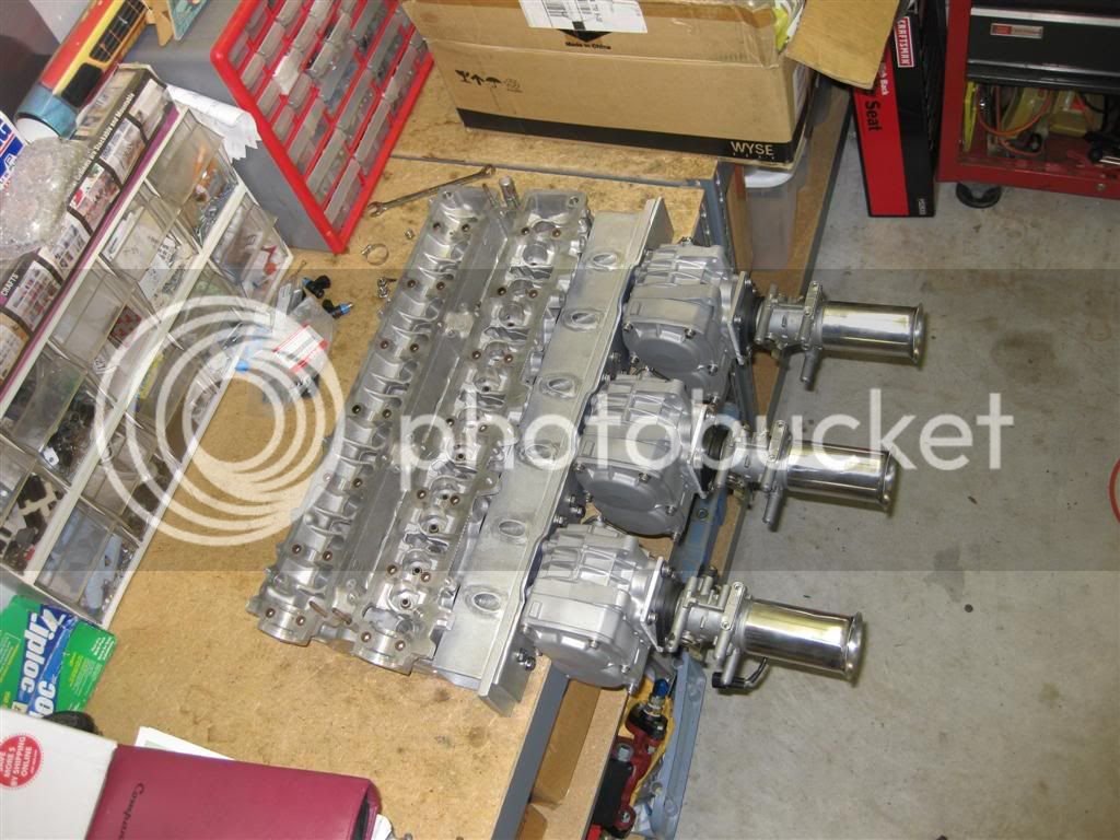

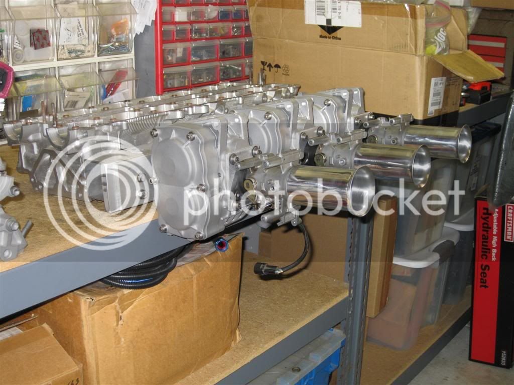

Here you can see the mechanical fabrication of the intake manifold is nearly finished (still has open ends) and the superchargers are bolted up to it and the manifold is bolted to a 2JZ-GTE head. Note the injector bungs on top. Those were a b*tch to get in and get right.

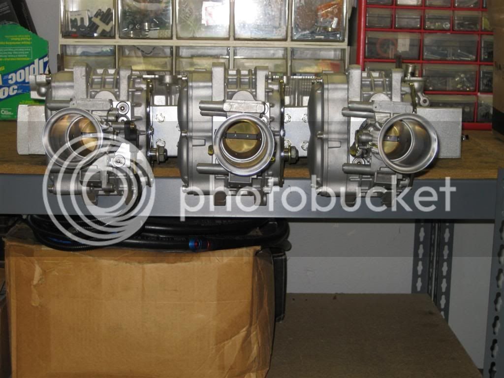

The throttle bodies are from a Suzuki 750 GSXR. Air horns are from a set I picked up awhile back off eBay.
