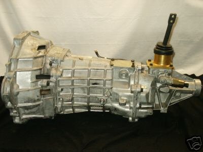

Check out this T56 from the V10 Viper..... WOW....
Gear Ratio
1) 2.66
2) 1.82
3) 1.30
4) 1.0
5) .74
6) .50
Rev: 2.9
Torque 525 lb ft

so where are these $700 T56s found? on ebay all i see is $2000, the picture lex posted is from an ebay auction thats starting at $2,195.00
