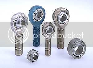

I am leaving for my local Ace Hardware for my endlinks. I googled a few DIY endlinks, it's pretty straightforward. I plan for (4) 1/4'' heims(spherical bearings if you will) with either a threaded center shaft (steel) or if i'm lucky one threaded joint with a threaded body-heim for the connection... if your ride is lowered at all then the height will have to be shorter anyway. Once i make some purchases and take some pics i'll start a new thread.
Well I don't have a camera right now but I made 2 sets of spherical endlinks. The rear links only needed to be 5'' long so I picked up (2)male (2) female Aurora 5/8'' Spherical bearings and simply threaded them into each other with a nylon locking nut. The entire piece is 10x more rigid than my OEM plastic ones. I noticed my car's rear end corners flat as my 7/8'' bar now feels like 1.25''. I chose a quick route and used an allen bolt with nut instead of clevis ends and bolt so I have a slight bind under total suspension trravel but it's mild. The fronts were a little harder as the shop I was using had no more female ends.. so I had (4) male aurora bearings also in 5/8'' and needed a 7'' length so I welded each rod end inside 5/8'' steel tubing and painted black. I made the mistake of not using 1/2'' rod ends as the front bar has a larger bore but so far they have held up my 1500mile colorado/california trip w/ no issues :dunno: cost around $25 for rears and $30 for front

Good write up. So you can get these Aurora bearing at any hardware store? Hmm... I wonder if the Home Depot near my house have it? Anyways, looks good man. I'm still waiting for the pics.:biggrin:
