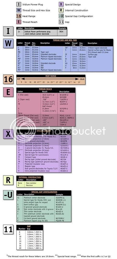

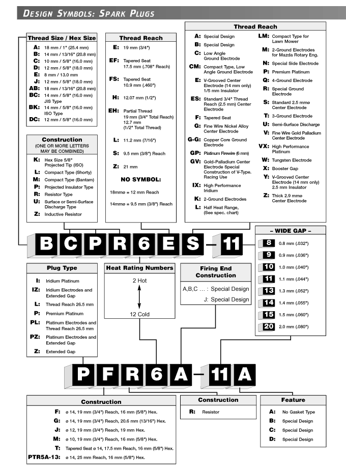

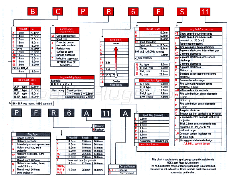

Stock 1uz-fe plugs: NGK Denso
Normal/OEM Iridium: NA IFR6T-11
Premium Iridium: BKR6EIX-11 IK20
Original OEM (Platinum): BKR6EP-11 PK20R11
Premium Platinum: BKR6EGP NA
Standard: BKR6ES-11 NA
Standard, Grooved Strap: BKR6E-11 K20R-U11
