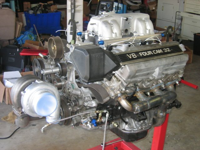

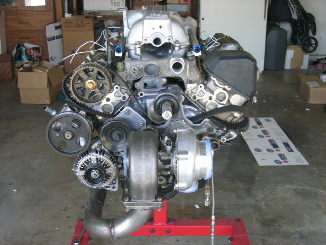

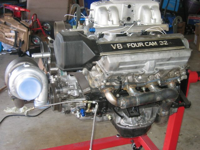

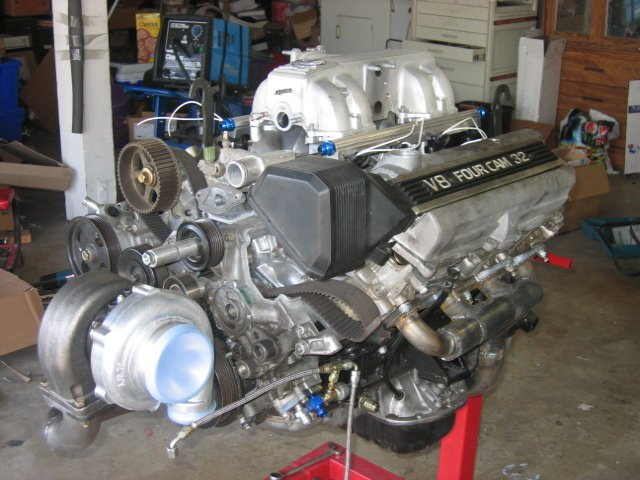

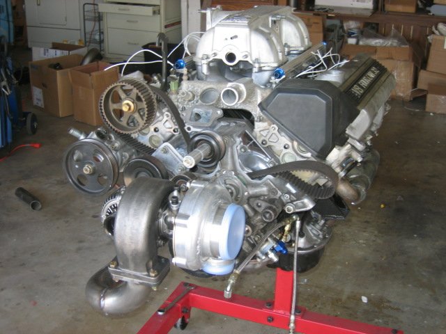

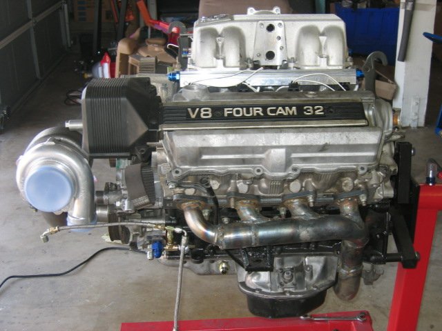

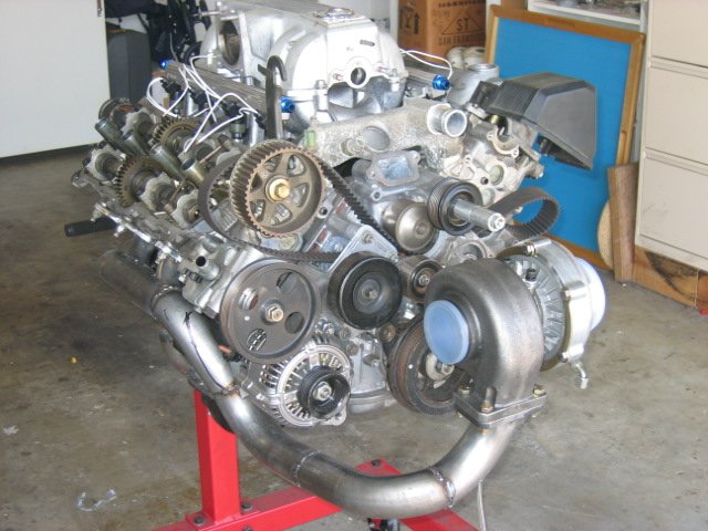

This is no mean by saying its done and its no mean by saying its the best design. Once again, this is an entry level for an average SC400 owner. This system would work best with ceramic coated pipes along with a ball bearing turbo like the GT30R or GT35R.
The down pipe and WG still need some work. However, I am still not sure if this will fit into a SC400 or not because of the cross member. We need to install it in order to find out. I will be putting some V Bands along with one or two hangers.
Do you noticed the header is one piece instead of two pieces? This header was designed with the intension of minimum of maintainence. This header will be install from the bottom with special bolts for the headers. This log style header is not the best design but its workable header for street application. If we have room then we can make alot better design.
![Single_Turbo_SC400%20001.jpg Single_Turbo_SC400%20001.jpg](https://www.lextreme.com/forums/data/attachments/13/13537-92b37fd220ef308a20e99997ae03d763.jpg?hash=krN_0iDvMI)
![Single_Turbo_SC400%20002.jpg Single_Turbo_SC400%20002.jpg](https://www.lextreme.com/forums/data/attachments/13/13538-00e7172e85b11ec9c8deb78bc1d1ada3.jpg?hash=AOcXLoWxHs)
![Single_Turbo_SC400%20004.jpg Single_Turbo_SC400%20004.jpg](https://www.lextreme.com/forums/data/attachments/13/13539-9ef4c2742647b6fca3dec3996217cbcf.jpg?hash=nvTCdCZHtv)
![Single_Turbo_SC400%20005.jpg Single_Turbo_SC400%20005.jpg](https://www.lextreme.com/forums/data/attachments/13/13540-aa45873217c78ad70f2a4c5f6963e721.jpg?hash=qkWHMhfHit)
![Single_Turbo_SC400%20006.jpg Single_Turbo_SC400%20006.jpg](https://www.lextreme.com/forums/data/attachments/13/13541-cd9f19d296391a9edfc6be84ef26fcd6.jpg?hash=zZ8Z0pY5Gp)
![Single_Turbo_SC400%20007.jpg Single_Turbo_SC400%20007.jpg](https://www.lextreme.com/forums/data/attachments/13/13542-8a36d213c3b259a566e2d82fccb7d7de.jpg?hash=ijbSE8OyWa)
![Single_Turbo_SC400%20018.jpg Single_Turbo_SC400%20018.jpg](https://www.lextreme.com/forums/data/attachments/13/13543-c109c589565831bf0d4d66ed66a45138.jpg?hash=wQnFiVZYMb)
