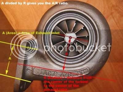

By measuring the turbine housing you can roughly work out AR...
thanks for that ill post up pictures of this scania thing i got, and ill try work it out. im leaning towards the big single because its a garret and them t3t4s are not branded and not keen on one spinning off a compressor nut or something like that. and its going to be easier making a single turbo manifold as its in a hilux engine bay and not alot of room. i guess you dont know untill its on.
