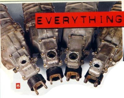

Just about to buy a w58 gearbox to go behind a 1uz but i'm not sure shifter position to get.
I know that the 1uz sits a little further foward that the standard engine so whoever has done this conversion, what shifter position is the closest to the orginal hole.
![Toyota_Supra_5spd_Shifter.jpg Toyota_Supra_5spd_Shifter.jpg](https://www.lextreme.com/forums/data/attachments/12/12876-1770796a589b74e43aa61036e39dcb04.jpg?hash=F3B5alibdO)
The above transmissions feature a range of gearshift positions as standard. Measured from the front face of the transmission these are : 18, 20, 21, 21.5 inches.
