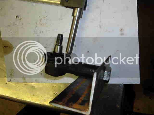

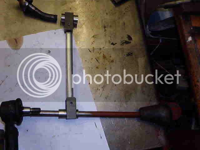

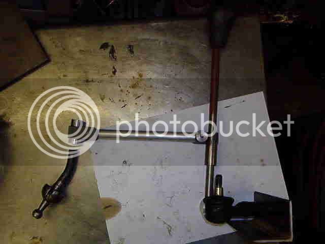

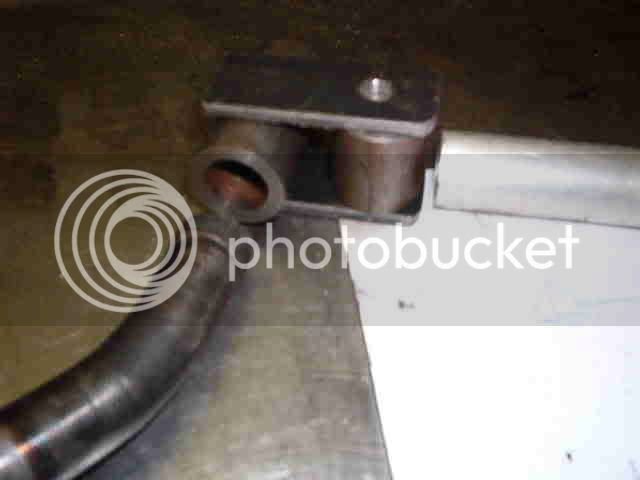

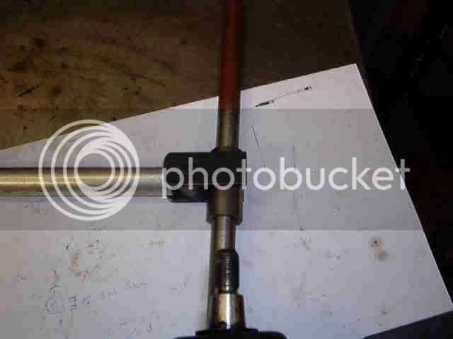

Hi It could be something about putting them in Nissans as Im doing the same thing with my s13 silvia. My dad works for a company that makes lotus sevens and hes shown me how to make a shifter extension. I have most of the parts made I just need to weld them up. This method has been proven to work well on some of the lotus sevens my dad has made.
I will post some pictures of the parts and a diagram.
Hope it helps.
Luther
Ok here are the pics hopefully you can see whats going on
Note: It hasn't been welded up yet.
The trick is getting a ball joint from a car and then finding a bolt with the right thread to screw into it. The ball joint then mounts to the top of the trannie tunnel and the linkage runs foward to the cut down w55 gearstick a 6mm bolt with a long smooth shank and a nut on the end will be used to connect the linkage to the two collars.
The collars are supposed to slide up and down the sticks and then secure with a grub screw once the throw has been tested.
Hope this helps I will let you know how it feels when Its on the car.
Luther
i can see how that works. Cheers
if it is all pretty tight there should not be too much slope in the stick. it would be easy to make it a short shifter as the length between pivots will change the ratio of the through.
Stirling

I've seen that done before on some Bmw's only thing is since hes using the ball joint and not a double hinge is the shift will feel "squishy" and wont have the stiff gated feel.
