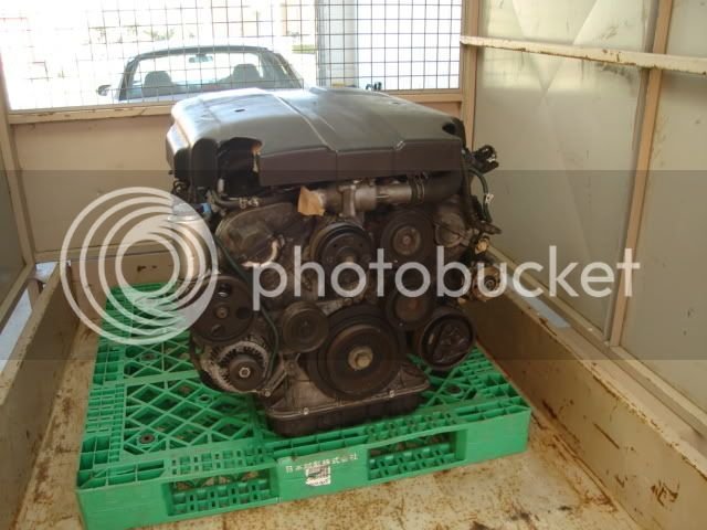

Jimmy at JPR Motor Inc. recently had a 1GZ in stock but by the time I decided to go for it, he had sold it about week earlier. (I bought a RX7 Turbo II swap a few years ago from him and he has always been a good source for quality JDM engine/trans parts) Thankfully, Jimmy was in Japan last week and found one for me some 3 hours north of Tokyo. This one is coming with the trans, wiring harness and the two ECU's and should be here mid April.

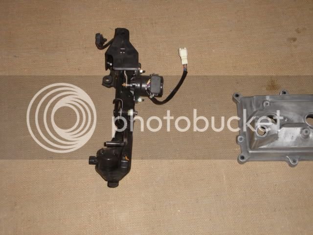

Initial plans plans are to swap it in bone stock with the auto trans and try to keep the stock intake manifold setup. It appears to be dual mode (intake flapper valve) and I have seen these good for 30-35 ft-lbs. on IS300 2JZ VVTi's. I do not mind getting a custom hood made but we will see how much room there actually is to determine which way I go on it.
