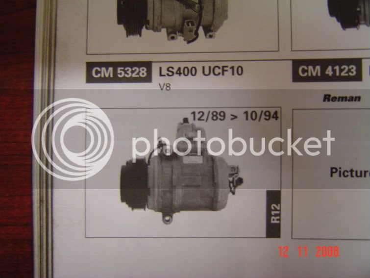

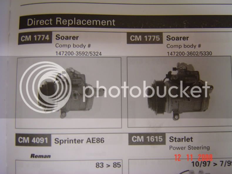

This may help to visualise for you.
You can see the slip sensor facing you right in the middle.
Superheat switch right on the end.
the one we had had the long comp mount on the rear,this customer wanted to fit the ls short mount,obviuosly it wasnt going to be a straight swap especially with the comp wiring being different etc.
Hmmmm, thats interesting..... Thanks for that post 1uzvl.........
I have never seen an SC here in the states with CM1774 compressor. The one that I have and every one that I have seen here is the CM1775 unit. My guess now from looking at those pictures is that the compressor that I have should bolt on inplace of the CM5328 unit
The UZS131 Crown ones have a much longer rear end which clashes with the LS400/SC400 dipstick tube.
Without the tube on there they are completely compatible. (ie even though its longer, the bolt pattern is the same)
If infact there are ones like the CM1774 I'm yet to see one.
