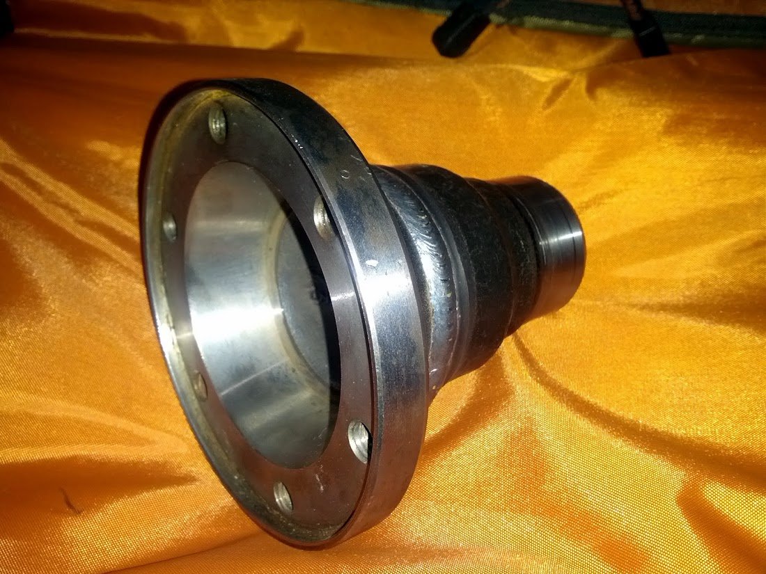

Take it to a transmission place ask them to swap the output shaft and extension housing to the 1UZ trans

and a custom tail shaft
