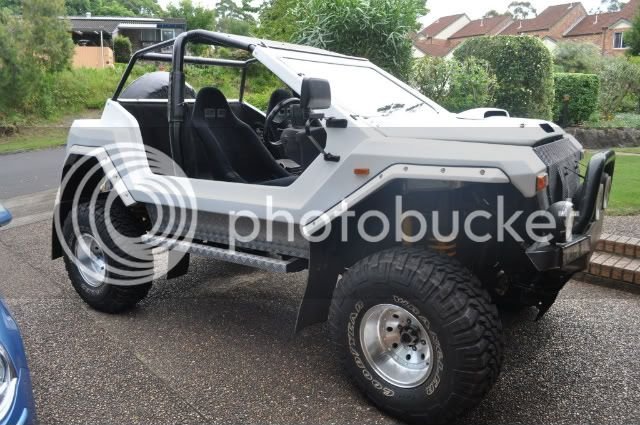

Not the prettiest car but quite capable off-road.
At one stage it had a hot Rover engine, then a stock 1UZ then a supercharged 1UZ (that never really ran all that well) and now back to a stock 1UZ.
I wouldn't mind a 3UZ but it would mean all new Engineering and I'm over getting it all through the system.
It runs Nissan Patrol 5 speed manual, Patrol axles and brakes all swinging off Rover suspension.
To give you an idea of its size the tyres in the photo are 35"(885mm) diameter and the car is 2.2metres high. The chassis is 600mm off the ground and it won't fit in our local Westfields Shopping Centre.

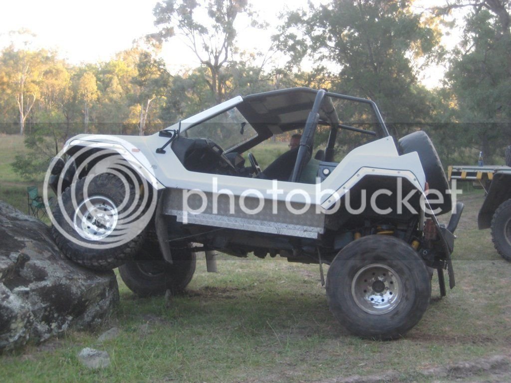

In this photo the aim was to get as far up the rock as possible. My car went about as far as the others there but they had air locker diffs so I was happy with my effort. The spring rates are all wrong for off-road as they were installed for the old supercharged engine and fast road work. Softer springs would have made the ride more supple and allowed more flex, giving more height up the rock.

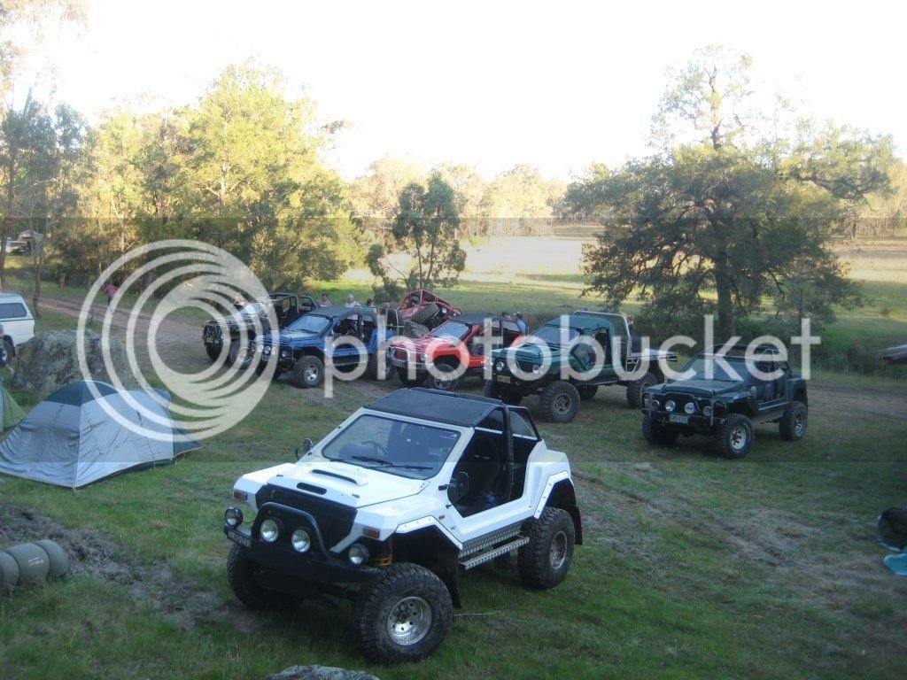

Just cruising one of the tracks in the area.
This is the largest gathering of these cars in Australia, ever. There are roughly 30 in Australia and 120 worldwide.

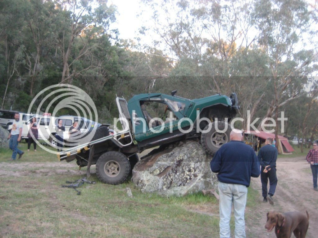

There's always someone who can go further!
This vehicle had portal axles and 37"tyres and diff locks each end. Truly awesome what it can do. I only run 35"tyres. The tow strap beside the car is to drag it off the rock as it is stuck on its belly. The owner is walking around the front of it going, nice job!
