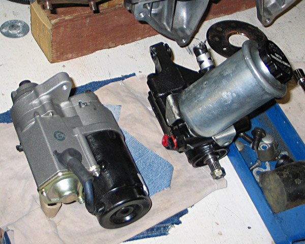

Hi all,
I am currently preping a 93 1uz for a transplant, it had a cut loom so i stipped quite a bit off to check wires whilst i reattach them so as per a lot of peoples recommendations i removed the starter for a once over.
Can any one give me any advice on rebuilding/cleaning up a currently working starter motor.
Thanks in advance

New starter motors are expensive in this part of the world. I think you will find it is pretty much a standard Denso unit similar to most toyotas. Any decent auto electrical workshop should be able to rebuild it for a reasonable price.
I'm sure that they use the same parts as thousands of other starters. Really the plunger and contacts is all that needs to be replaced. Along with a good cleaning and a little graphite grease and you practically have a new starter. An experienced tech can do this easily in 15 minutes once they have the parts on the bench.

Found a friend of a friend who rebuilds them and says i can watch as it is quite a quick job when you have the bits, apparently the internals do match other toyotas but the starter assembly is engine specific. (gets round the bill for a spit and polish problem) Should learn something too.
When i ran the armature assembly (the most major part of the starter with a separate part number) part number through the Toyota EPC it matches a lot of other things:

That confirms what you suspected about common parts.
Thanks for the advice, will leave it to a pro.
