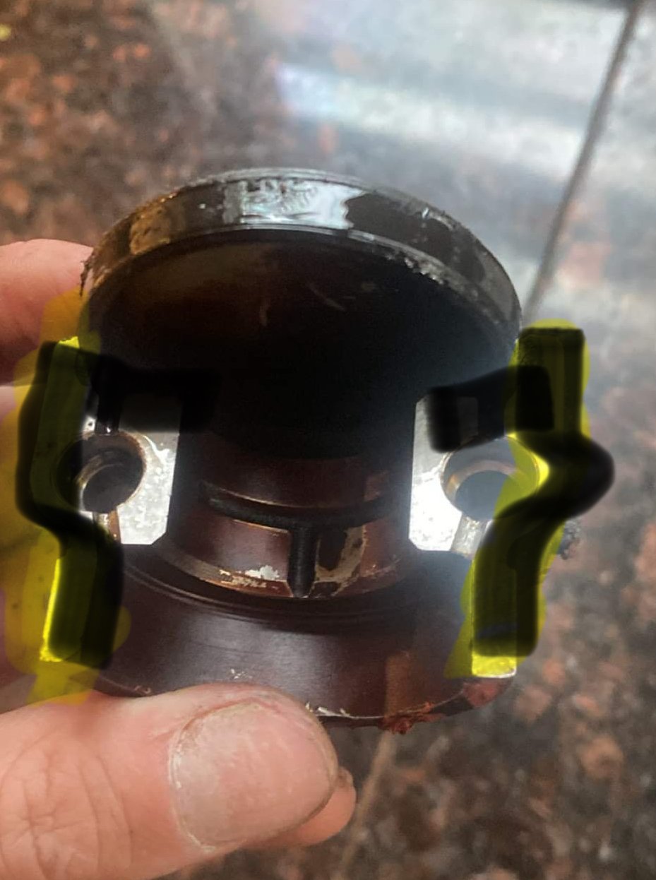

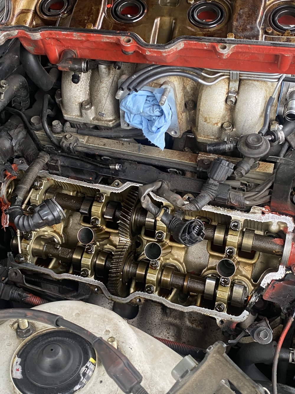

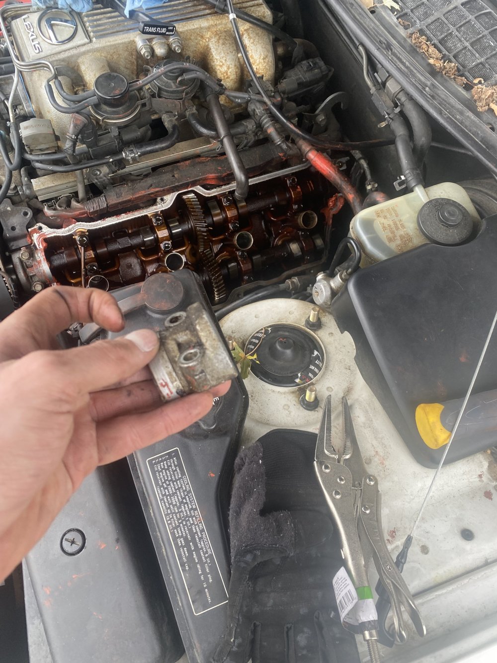

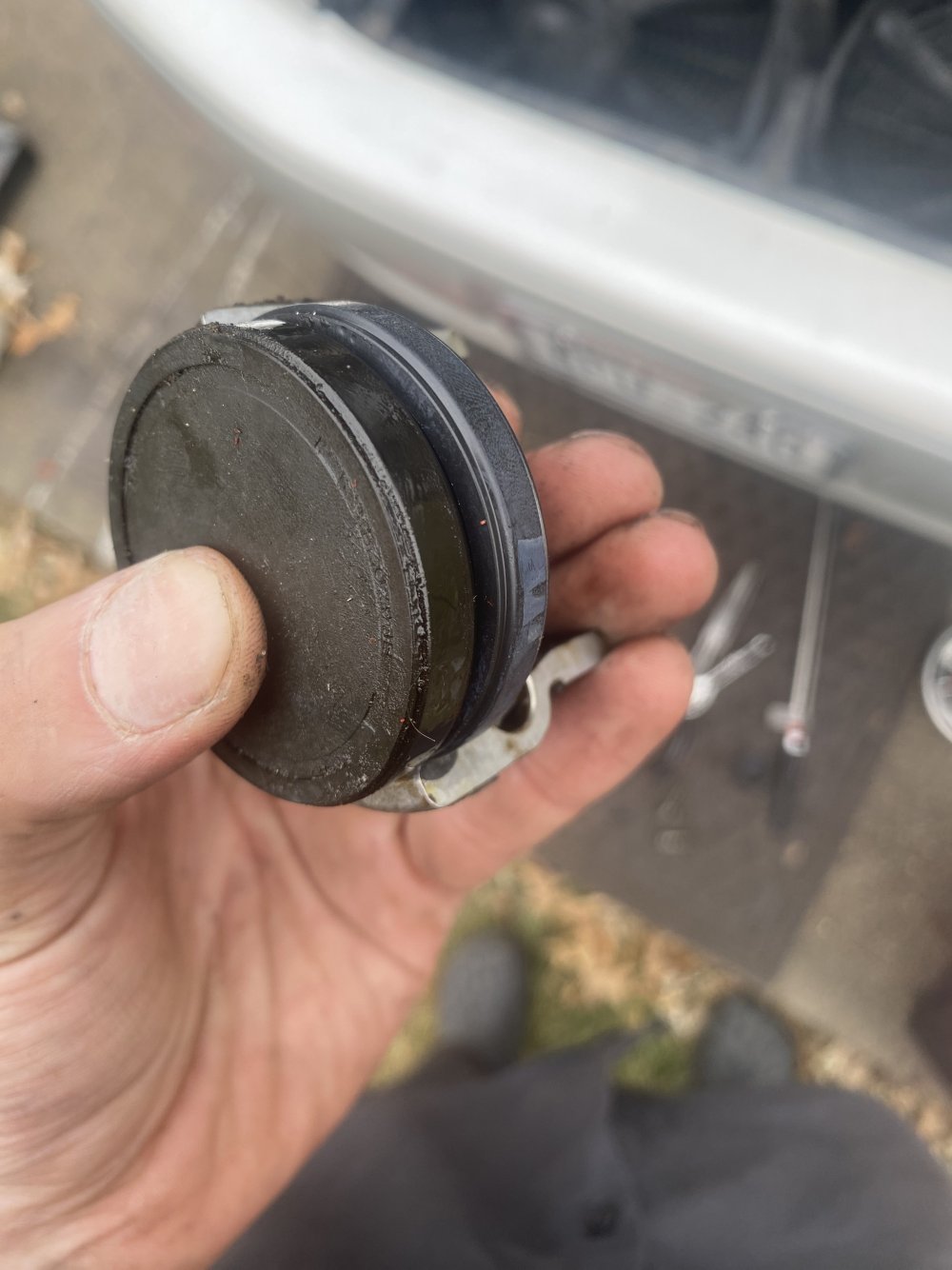

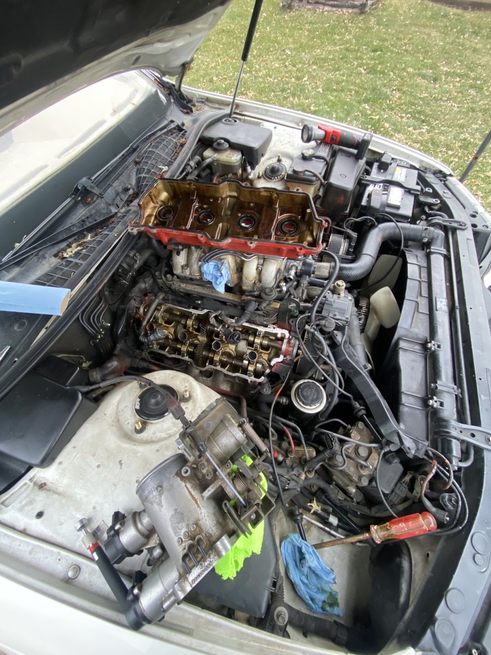

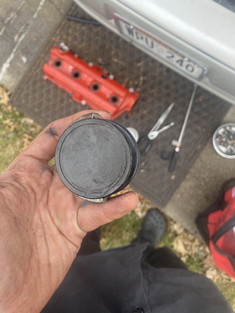

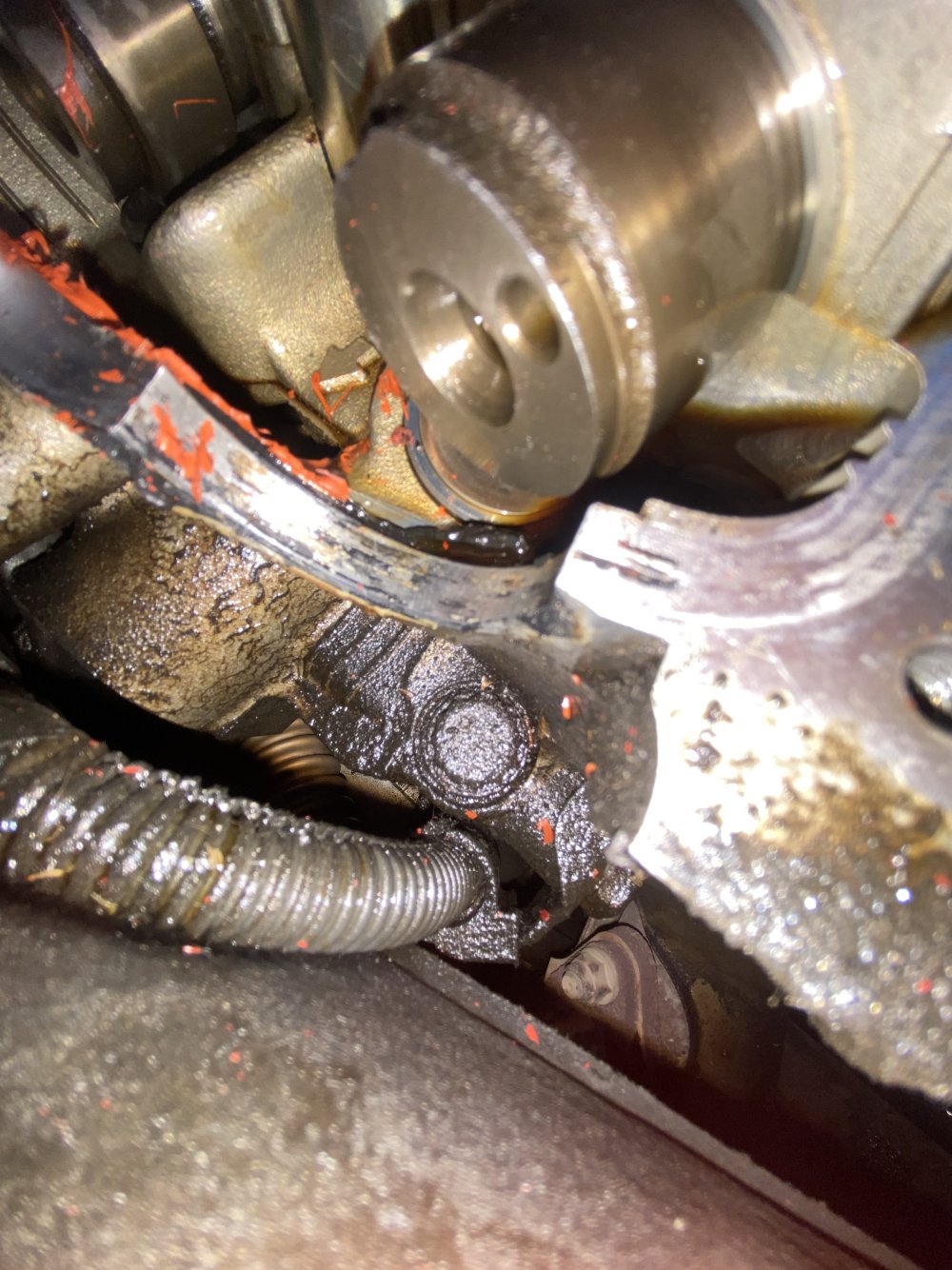

Hello everyone, my car is 34 year old and still figure out how oil leaking came from? ever you heard about mystery oil leaking came from? There have 2 side part of plug camshaft (black round) engine get oil leaking when you drive up the hill and oil alway flow push back against on the rear of engine. I replace them one drive side and passenger side is require remove to move all of hose,spark plug, and blah blah blah. One of hard things to do bracket for electric on the rear of passenger side unless you have bad day leaking on passenger side. Mine not leaking very lucky only leaking on moon half. I already installed moon half with Toyota glue seal. Good to go. I show you pictures look like. Last picture what i did Toyota F103 FIPG glue seal on it.
Camshaft housing plug- 11188-62010
I hope you will thank me in the future. That is why I set l post this because it is rare issues. No more oil leaking forever!
