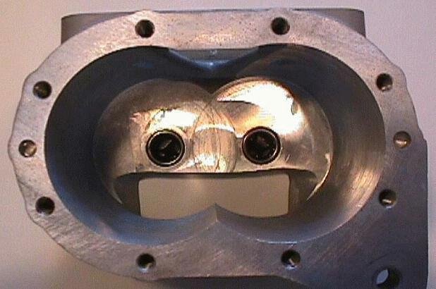

Figure 6 : This view shows some internal detail of charge exit area. Note the area increase and the radiusing on all the surfaces to curtail turbulence.

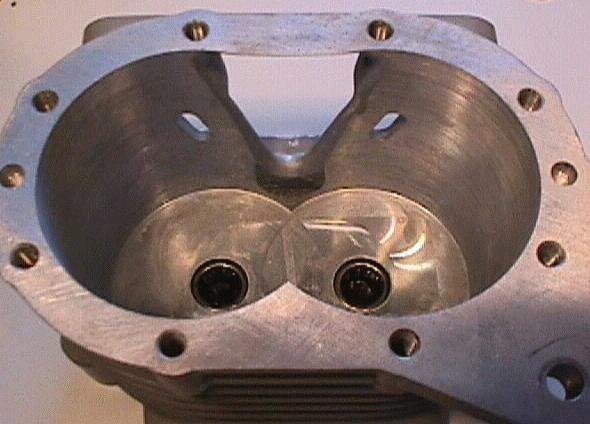

Figure 7 : This internal view shows the expanded and carefully shaped air entry at the back of the case. The shapes are designed to work with the charge exit area to provide 120-degree case to rotor timing and are, therefore, critical.

Thanx J,
It appears the greatest benefit for the roots style is lower intake temps. If it's already done then still worth persuing i guess.
