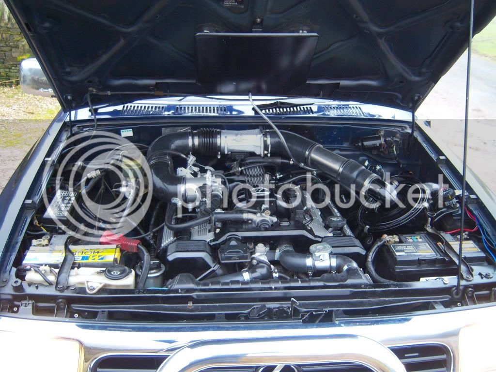

Here's a few I've done for customer's Hilux conversions.....The first two I sprayed with heat resistant aluminium paint, with red and blue translucent glass paint over the top in the first photo.Picture003-1.jpgengineswap019.jpgThis one I sprayed with black gloss engine enamel.Picture024-2.jpg

That stuff will work, not seen it here in the UK.I bought my paint in cans/jars and sprayed it on with an airbrush.Once it's dry, you can scrape it off the 'fins' on the plenum and polish them using progressively finer grads of wet-or-dry paper.
Cool, you have done a nice job on your conversions,
I have used the silver base coat in this paint, comes up real nice,

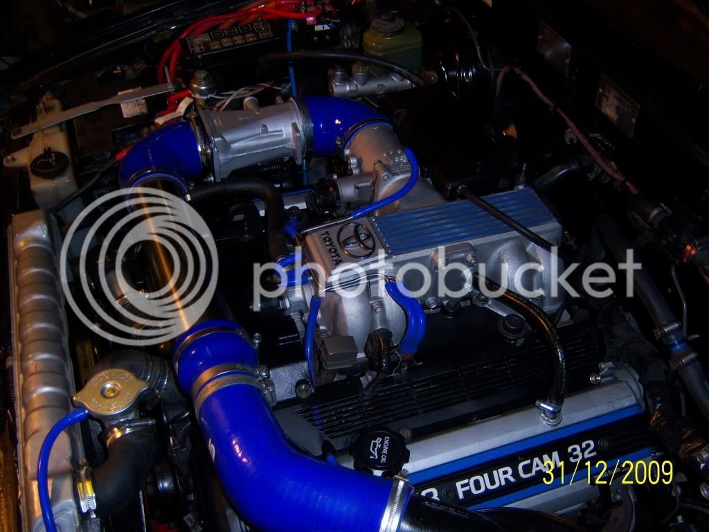

One done last year using VHT engine enamel shown during trial fitout. Got removed and final cleanup after the pic was taken and after 25k now still looks good. Colour is a Ford Blue which matched the Surf quite well. The current build is painted red on the rocker covers as the owner wanted to confuse people into thinking that she has a Beams engine and we've done a few "Black tops" all with VHT engine paints. The trick is that everything has to be perfectly clean prior to paint or no matter what you put on it will fall off

This is engine is really beautifully painted in red...
Never seen V8 four cam 32 engine before painted like this .....
