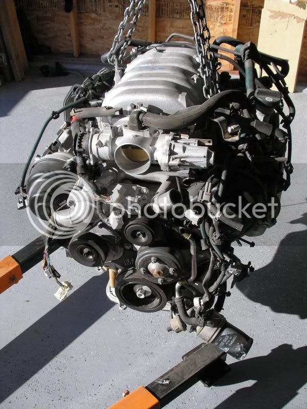

I have a low mileage 2UZFE that I'm going to be mating to a manual transmission and then boosting. I'll start with no boost (just want to run the 2UZ for a year or so) then I'll do 7 PSI with twin (stock) CT26 turbos, then go for 17 PSI after I upgrade the bottom end and go 60-1 on the turbos.
The 2UZ has coil on plug ignition and the only part of the harness that is cut is where the 2WD automatic transmission used to be.
