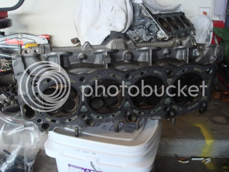

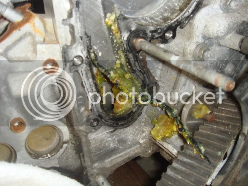

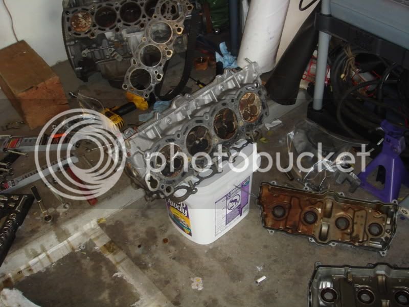

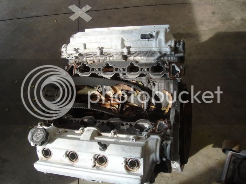

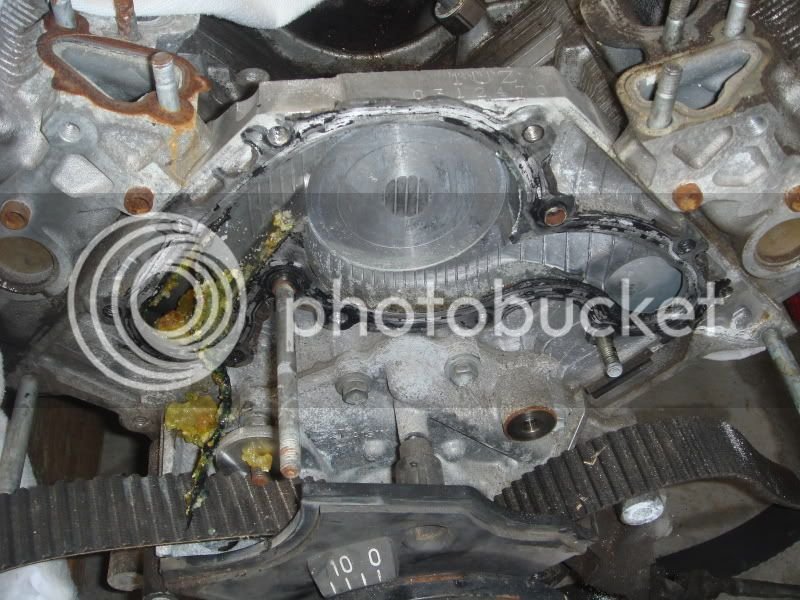

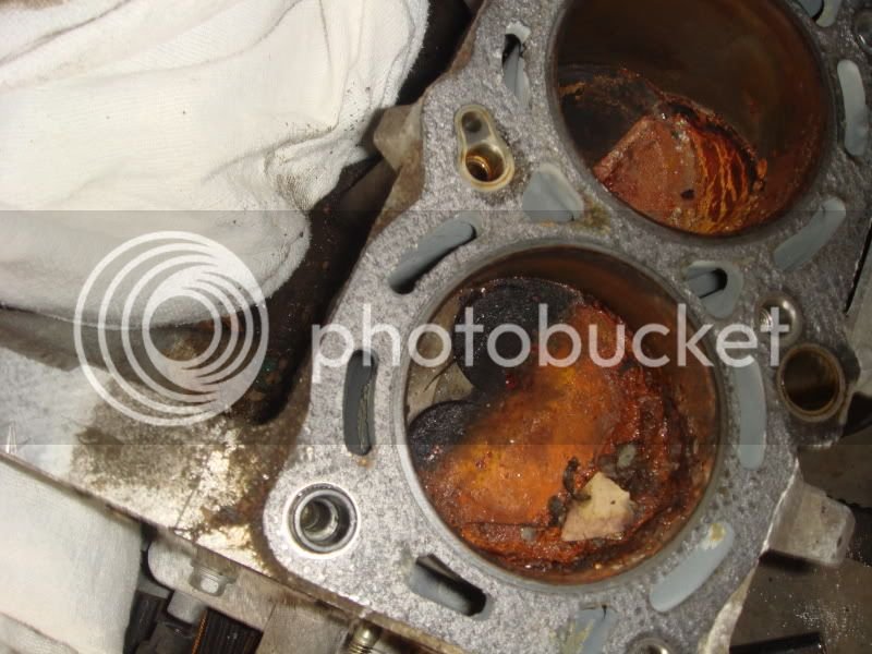

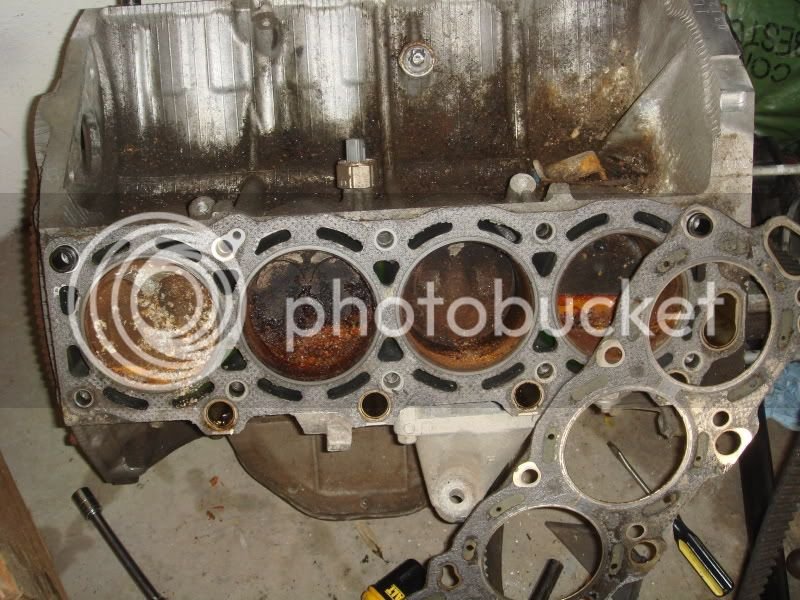

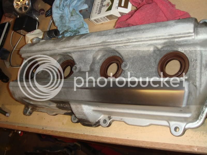

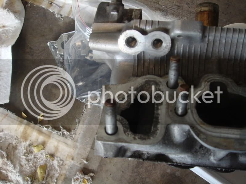

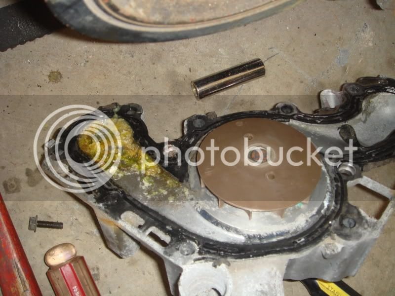

well I took the head's off and this is what I found enjoy the pic's
Damn! That's a retired engine sitting outside for awhile. Basically that's just a long block that needs a complete rebuild. You'll need new bearings, rings, gaskets, and perhaps a new honing job if the cylinder walls are rusted/scratched. The pistons & rods can be cleaned & maybe re-balanced, too.
I have one like that as a dummy engine...
Would be less $$ to buy another complete engine..
Recon it if you want serious power...
