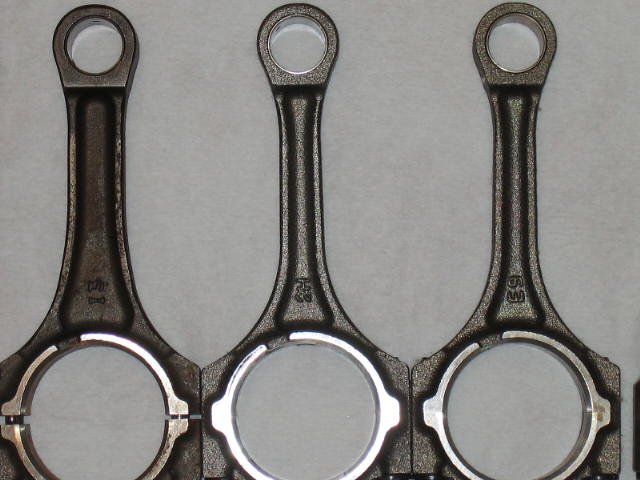

There are couple of flaws with the 2uzfe for FI application. First, its obvious would be the rods. Those rods are almost like the new Scion XB. They are as skinny as my small finger. Here are the 1 to 3UZ rods in order:
![IMG_0071.jpg IMG_0071.jpg](https://www.lextreme.com/forums/data/attachments/12/12986-2f97bc368069c0c1fb042833d4d2e12b.jpg?hash=L5e8NoBpwM)
For a decent size engine, the rods are just too small. I personally have seen 3-4 shortblocks with broke rods. Now those broke rods were NA application. I havent seen or heard of any 1uzfe rods being broken yet.
For any 2uzfe FI application, I would suggest an easiest and cheapest way. Yes, the 1uzfe rods would work. They are direct bolt on. 1UZFE rods are cheap you can get them for $100 per set. For less then 8-10 psi, those rods should be worry free. However, greater boost would require stronger rods (There was a Group Buy on Forged Rods, please contact Rod aka Zuffen for more details) With a good set of rods and pistons, the 2uzfe would make some killer hp. Even with two bolt main, its pretty strong for most mild application. However, if you got you hands on a set of 1 or 3uzfe main caps, then you can do either a 4 or six bolt main conversion. 4 bolt main will be very nice however, 6 bolt main will be overkill. Don't be surprise to see my engine with 6 bolt main.
I think with good rods and pistons, the 2uzfe would be good for 20-25 psi. Currently Ross is making me some 2uzfe pistons handling 30 psi. My conclusion would be if you want your car to handle and make good power, then the 1uzfe is very sufficient. However, if you want the extreme power, then the 2uzfe would be the block of choice. One other combo you might consider is using 1uzfe crank instead of 2uzfe crank. 3.25" stroke vs. 3.31" stroke. Its not much but will help some rev. The combo i am building will be using 1uzfe crank.
