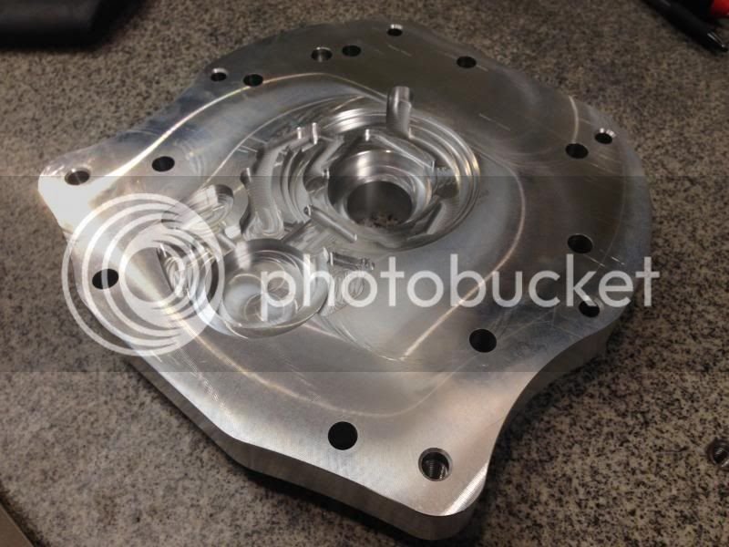

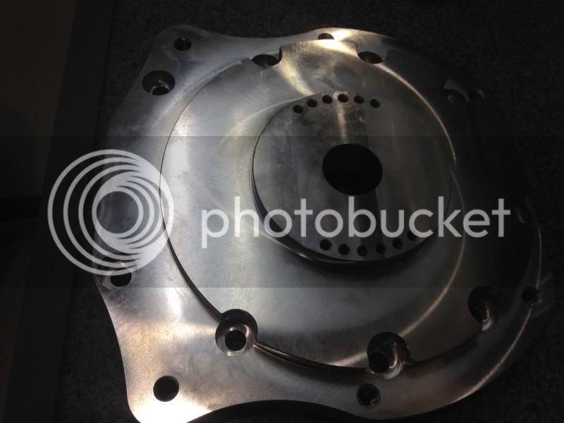

I've literally been dragging my feet on this project, but it's finally done and complete. The new adapter eliminates the need to cut the guide tube that's attached to the bearing cover in order to use the GM t56 throwout bearing.
![IMG_21821_zps11fed9a2.jpg IMG_21821_zps11fed9a2.jpg](https://www.lextreme.com/forums/data/attachments/22/22905-0875d1ee71e09240913f097fde75124b.jpg?hash=CHXR7nHgkk)
![IMG_21801_zps12ccd576.jpg IMG_21801_zps12ccd576.jpg](https://www.lextreme.com/forums/data/attachments/22/22906-9ab49f4697add5a2f309b650330b0c77.jpg?hash=mrSfRpet1a)
the new adapter locates directly on the output shaft for the absolute best alignment possible!
