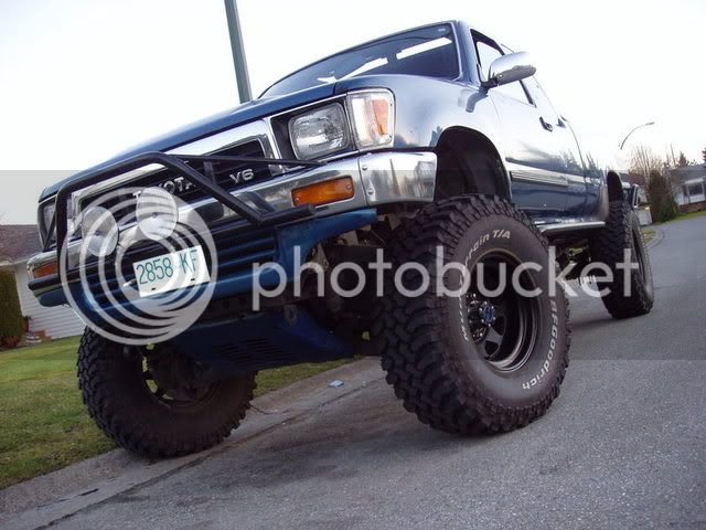

Let me tell you guys, the moment I heard the 1uzfe swapped into a certain 4runner. I was hooked! I dream of the day I don't have to "plan" my approach to big hills, and not have to worry about putting my foot to the floor to get up to speed on the hwy on ramp. Poor little 3vze is fighting a loosing battle pushing all that weight.
