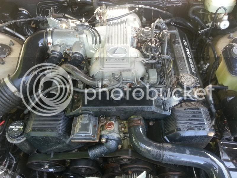

This is what I'm working with:
I hosed it down so it looks better than it is. Elbow grease is fine for the small number of large things like the intake manifold (by the way really kick a$$ work fugly!), but is there any short cut I can take with all of the rusty looking fasteners, hose clamps, nuts, bolts, etc that will make my life easier besides wire brushing each and every one of them? Even the igniter screws are rusty looking. Yes, I'm looking for the easy way out... :D
At least it runs really well! If anything, it'll match the Cressida it's going in hahaha :p
Any rust you have on bolts ect will just come back again if not painted or coated with a clear. As prev mentioned, repace clams bolts with newies if you want the clean look. You will need to pull some covers and bits off to clean it properly. There is no easy way. Time, elbo grease, de greaser, alloy etch, steel wool and some silver paint on small bits will make it better.
