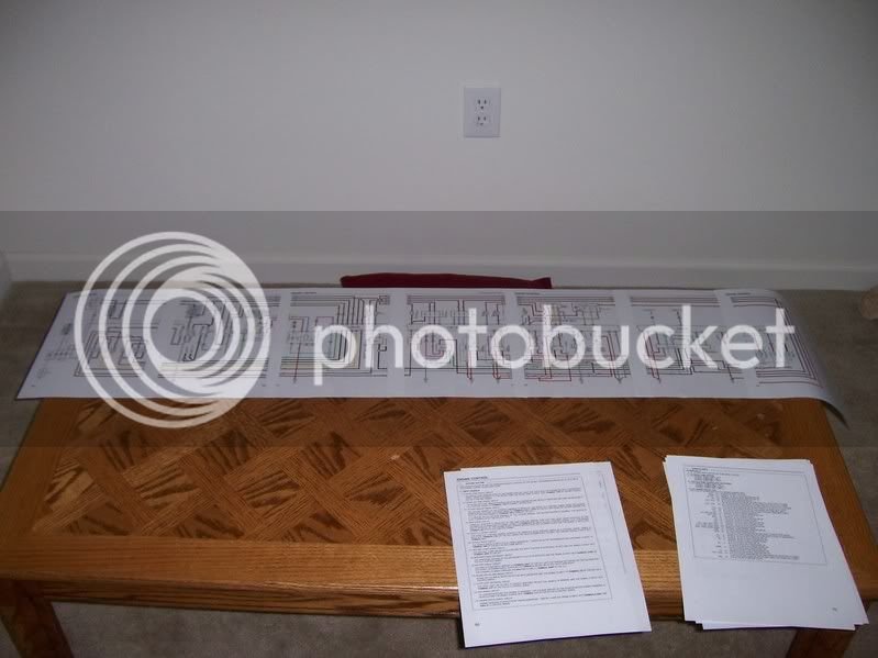

HI gang, regarding my swap... This past weekend I took out my 1uzfe, well looking over the wiring harness I realized, I dont want wiring out my ass. So whats the best way to take care of this? EMS yes, but I sorta wanted to use the OEM computer at the moment. Im probably going to use a turbo MR2 engine harness with NA MR2 car harness and just use the injector harness and ecu from the 1uz. Its a big mess to me, hopefully my friend can help me out.
Does anyone have actual wiring diagrams, and looking at the swap, I see these motors going into 240's, miata's, supra's, trucks, but most of all, I saw even that bike! So am I making this to difficult in my mind? I just see so many things, I guess since I dont know what they do that Im worried.

Jeffrey, it sounds like you need to get the Repair Manual, Electrical Wiring Diagrams, and the New Car Features books about the 1UZ and the cars it came in, and start reading. Then get someone to work with you on the new wiring and what needs to go where.
Go here to get to the Toyota TechInfo website page to order hard copies of nearly anything Toyota prints for their cars: http://www.techinfo.toyota.com/public/main/mdc.html
When you call, ask them for the last major revision of the NCF for the engine you have because Toyota doesn't reprint the full tech description in the NCF every year, only when there is a major change in the motor (like when it went to the VVTi configuration in 199:cool:.

As far as wiring goes..toyota is really good at keeping the engine harness seperate from body harness...so what im doing with the v6 for testing is keeping the stock harness/ecu for my first start up then going to ems (something like you want to do)
Now all you really need is the engine harness and find the wires that the ecu needs for "switched" and "constant" 12v power, then the grounds as well and there ground points.
yeah, thanks for the input. I have a guy locally thats great at wiring up custom setups, he is doing the job for me, I believe he is on the board now as well named NODE. I have the SC400 complete car harness as well as engine harness so hopefully we have more than needed, as well as having the full car if I left off any plugs or sensors. The best thing is that all the wiring pin outs are labeled the same from an MR2 to a SC400. Although the SC has more output/inputs (o2 sensors and two distributers) it should be a problem!

see the thing is, if you just got a regular engine harness it just plugs into place into the ecu and all the sensors...the only thing you woul dhave to splice in is the power and ground points.
The only thing is the second o2 you have to either get a URDUSA secondary O2 sensor simulator or get node to put both sensors in there :)
yeah well I think I have 4 o2 inputs! theres two in the manifolds and two after the cats. Maybe they all could be wired together? if one failed I would have to check all I am guessing.
well i would just use 2
if your keeping this stock NA
then get node to make to ports jsut before each runner connects to each other.
Then find out using the book or someone on this board what the Voltage on the rear 2 sensors require ot be happy. At which point you can just copy the voltage using resistors or something (which urd uses).
