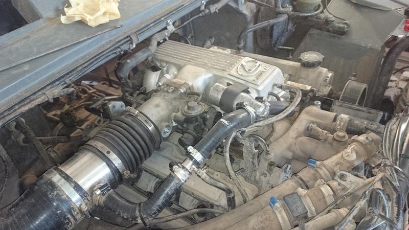

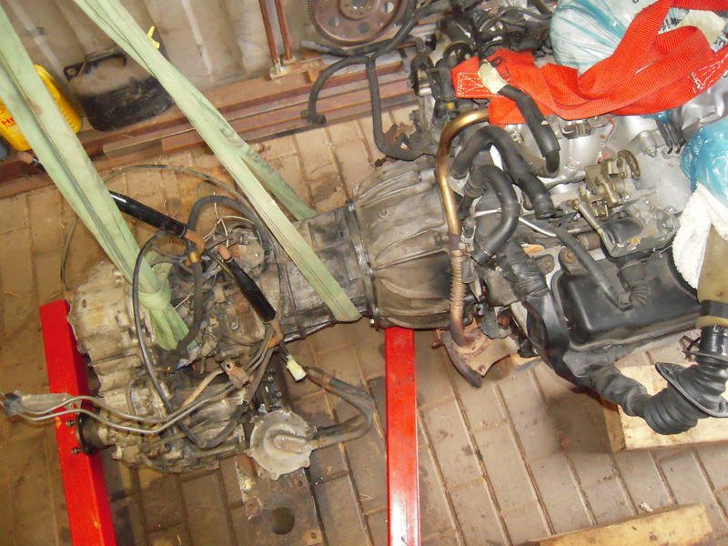

Drivetrain:
1uz-fe (from a 92 LS400) mated to a R151f (from a 89 LJ70 Landcruiser), LJ70 axles, ARB f&r, radflo coilovers... pto winch and so on.
![25217327mv.jpg 25217327mv.jpg](https://www.lextreme.com/forums/data/attachments/23/23116-9491a454f2251898d8b00df9ecd261bb.jpg?hash=lJGkVPIlGJ)

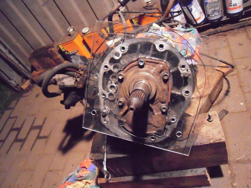

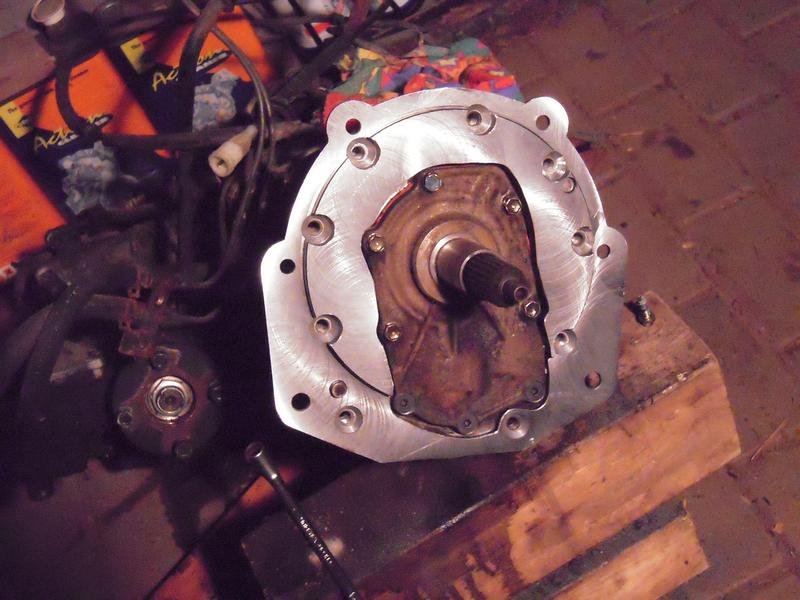

We've build our own adapter plate:
![25217323vw.jpg 25217323vw.jpg](https://www.lextreme.com/forums/data/attachments/23/23117-ebdc01e7bd397365aa78c373ae5ceaad.jpg?hash=69wB5705c2)
![25217324el.jpg 25217324el.jpg](https://www.lextreme.com/forums/data/attachments/23/23118-29d50bbec0c273eb80671fa06111791e.jpg?hash=KdULvsDCc-)

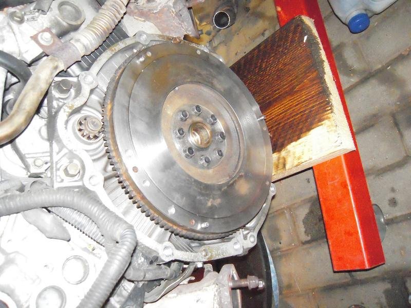

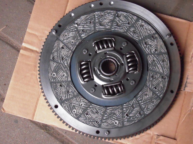

modified 3vz flywheel:
![25217325sl.jpg 25217325sl.jpg](https://www.lextreme.com/forums/data/attachments/23/23119-5384bf38d552eb1da0ba6872f009071c.jpg?hash=U4S_ONVS6x)

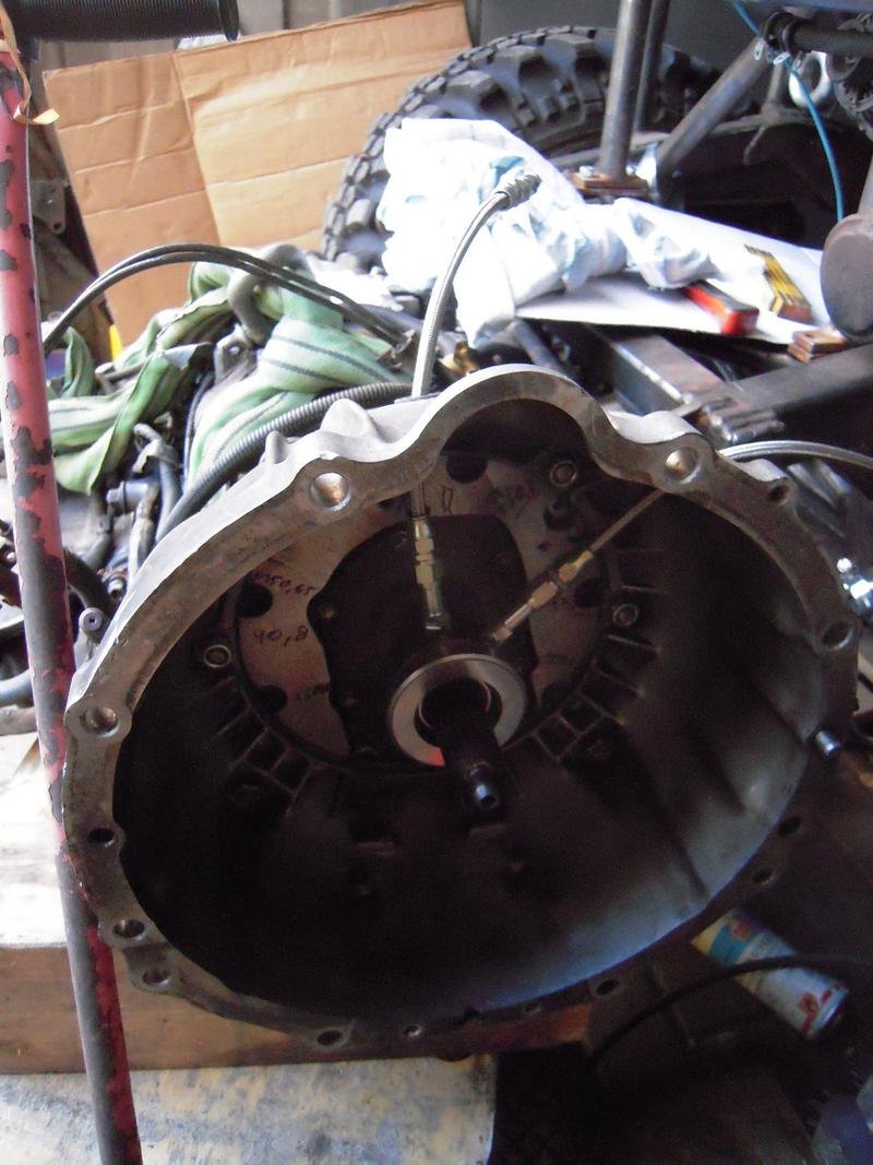

exedy clutch:
![25217326ke.jpg 25217326ke.jpg](https://www.lextreme.com/forums/data/attachments/23/23120-8f3d7e58ebb0d7b6a3e5bb9748f19f4d.jpg?hash=jz1-WOuw17)

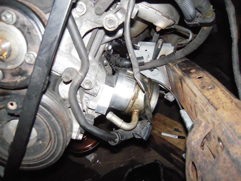

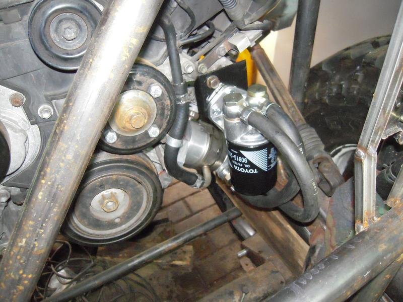

oilfilter:
![25217402yg.jpg 25217402yg.jpg](https://www.lextreme.com/forums/data/attachments/23/23122-9c5e792dd322e4792513b2b822ec3bc9.jpg?hash=nF55LdMi5H)
![25217403eb.jpg 25217403eb.jpg](https://www.lextreme.com/forums/data/attachments/23/23123-40cb4080d64bb5f72c9bb22e26519d6b.jpg?hash=QMtAgNZLtf)

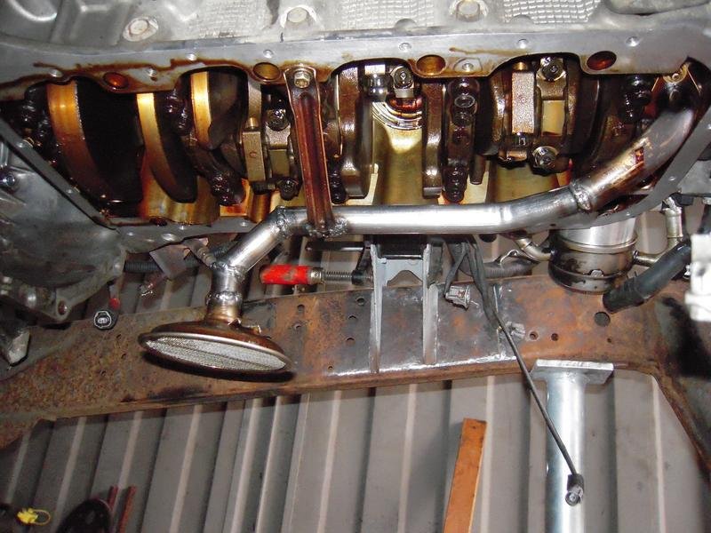

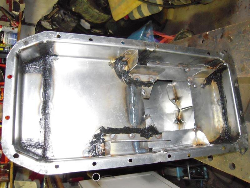

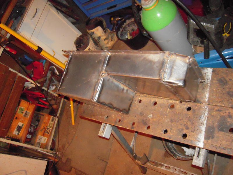

oilpan:
![25217404so.jpg 25217404so.jpg](https://www.lextreme.com/forums/data/attachments/23/23124-6268ab88fd54eeb3e5dde7a6a0520dab.jpg?hash=YmiriP1U7r)
![25217406vy.jpg 25217406vy.jpg](https://www.lextreme.com/forums/data/attachments/23/23125-5c501cef613ce1b9e43074e7aeebfbcc.jpg?hash=XFAc72E84b)
![25217408wf.jpg 25217408wf.jpg](https://www.lextreme.com/forums/data/attachments/23/23126-45f60aba8a5aaa6f5d62a94d37680689.jpg?hash=RfYKuopaqm)

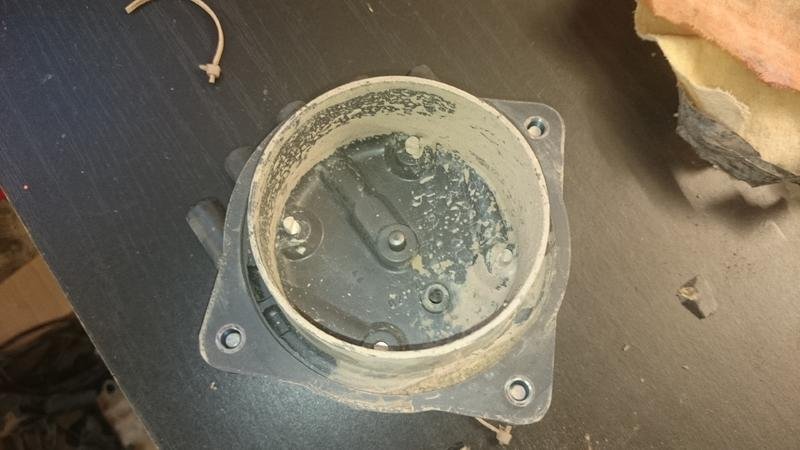

the engine ran great with the original ECU, but the distributers didn't like water![Wink ;) ;)](https://cdn.jsdelivr.net/joypixels/assets/8.0/png/unicode/64/1f609.png)
![25217503rj.jpg 25217503rj.jpg](https://www.lextreme.com/forums/data/attachments/23/23127-da1b057f94fad1ba6e4e2ca0fe9a26a0.jpg?hash=2hsFf5T60b)

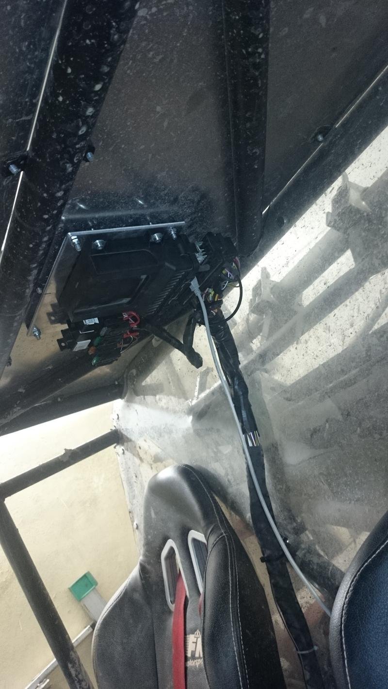

so I installed a MS2 (kdfi 1.4 from K-data, MS2 V3 with a lot of extras on board)...

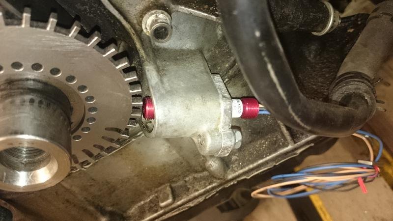

I had a 36-1 triggerwheel made, replaces the original 12 teeth wheel.
![25217505ue.jpg 25217505ue.jpg](https://www.lextreme.com/forums/data/attachments/23/23129-9a4305c8a6fe704c376d6fcf78b7b5d3.jpg?hash=mkMFyKb-cE)
also in den picture the hall sensor.
