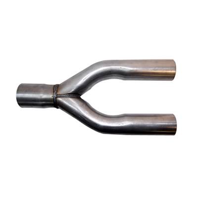

I just picked up a second 1991 LS400 for a daily driver and want to keep it an N/A application. I decided to start an exhaust upgrade and just picked up 2.25'' mandrel bends that are pre cut, and plan for 2 summit race 2.25'' in/out offset mufflers and plan to keep the exact Y-pipe design. I am starting mine at the end of the first Y pipe after the cat, but need a few tips on making my merge collector. I ordered a Jones Y-pipe from Summit.com but the more I looked at the design it looks like the merge point is too wide. I have a decent welder and a miter saw. Basically what do people do when they weld the 2 halves togerther? I am having a hrd time visualizing the collector at the bottom, do you need to bend it to slip over?
Also, if I plan for 2.25'' mandrel, should I be running 2.5'' or 2.75'' main pipe? I decided that 2.0'' mandrel wasn't quite rewuqires because this LS has SC400 gears inside and the bottom end mimics an LS with a torque convertor so a slight loss down low is ok.
