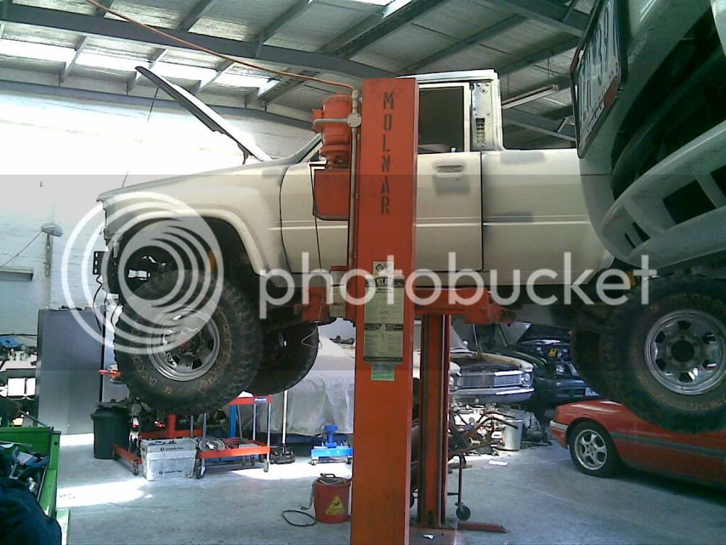

For a while, i had no idea what i wanted to do in terms of power, already having a Hilux with a holden 308, that seemed pointless, thought about turbos, then i came across a oppurtunity i couldnt refuse. a bloke in newcastle was selling a writen-off mazda b2200 ute, with a 1uzfe bolted to a supra gearbox. haltech computer. and a 9inch.. Road trip No2
brought that back and stripped that down, carefully though, never know what you going to need down the track..
I was adamant that I wanted to keep the original cross member and tail shafts lengths when fitting the motor, this would eliminate any vibrations, other than the tyres, (My Hilux has massive vibrations because of chopped tailshafts and custom cross member). the sump was custom when I bought the motor so I had no problems with that. However I needed to make a remote oil filter setup coz the filter would of fix my chassis mounts.

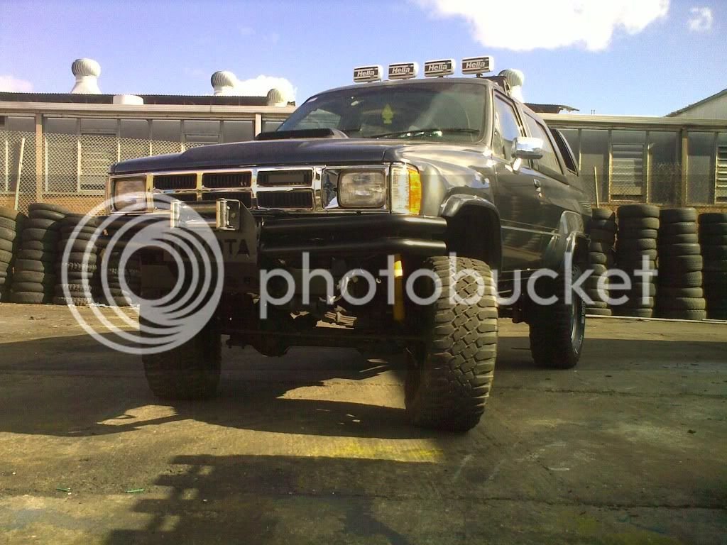

The bulbar: My idea for the bulbar was for it to be a tube bar, that could house a winch, can hold 4 spotlights, have a unique look to it, had to scream TOYOTA. And had to have LED indicators. That’s what I started from.
And ended up with this:
The Finished Product:
