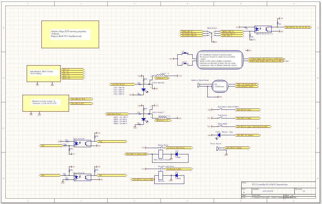

Gents I am in the process of making my own auto controller for the A340 auto to make it manual shift. I'm hoping someone can help me with the following questions:-
S4.. line pressure control solenoid.. When should I be operating this solenoid?
What should the default positions be for all solenoids when in Park, Reverse, Neutral?
Help would be appreciated.. Thanks. Ivan![Smile :) :)](https://cdn.jsdelivr.net/joypixels/assets/8.0/png/unicode/64/1f642.png)
