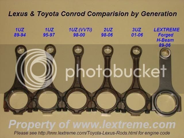

You should be fine with stock with the exception to the rods. You WILL need rods to hold a 125 shot. All toyota v8 rods are very weak w/ exception to 1990-1994 1uz. You can swap early rods onto your 2uz crank, or you can run chevy forged H-beam rods. Aside from that the 2uz has the 2uz has the strongest block of the series with a much better flowing head/intake manifold.
Here's how the toyota rods stack up:
