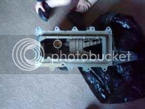

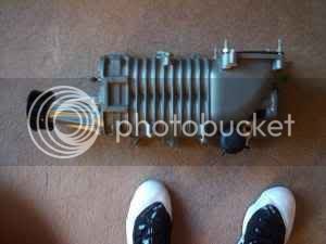

Just found this M112 for $400 OBO right up the street fromn my house. Based on these pics is this the right orientation to fit under an SC400?
Are you sure you'd want to go through the trouble of putting this monstrous blower in a car meant as a daily driver?
Daily driver means daily entertainment :D. I need this to keep myself from stressing out on my ls project.
I just had a spring cleaning garage sale and made a little cash. All thats really necessary is a rush or bullet manifold to finish it off. Like the vortechs/prochargers, an m112 can be done rather cheaply.
blower=$350 (guy has an obo at $400)
rush manifold= $1000
FMU= already have
intake materials= already have
-The SC has a few more cc's of fuel flow. It can handle 7 or 8psi all day.
I have the tools to make the manifold from scratch out of steel but i'd rather spend a little to get a more effecient setup.
Is this for the 4.7L or your current daily? I think my M112 is done from the machine shop. Bullet's kit require bottom lip to be machine and you will also need the Terra Nostle for perfect fit. However, I think u should stick with NA for your daily....
