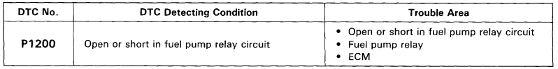

while vehicle is running the FPR never produces more than 150mv , the testing says the FPR should put out 9-14 v for 60 seconds then drop to 0-3 volts . So im guessing the fuel pump is bypassing the stage from light load to heavy load and its always running at heavy load??
Also i might add i am still running the factory cressida pump, circuit open relay ,and fuel pressure relay . the volume is the same as the lexus , and i have a factory 1uz fuel pressure regulator
