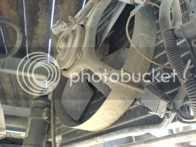

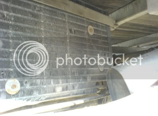

I mounted my condenser under the tray. I used a 16inch fan on my radiator. The
radiator fan pictured is actually a 14inch fan and I have upgraded to a 16inch.

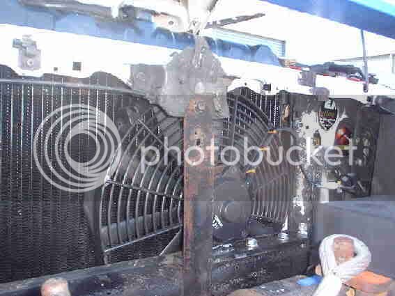

heres mine only got a foto of the engine side this ally radiator is the same thickness as the stock one but dual bypass and is slightly higher the thermo is a 16'' ice thermo and it has 15mm between the thermo hub and the engine pulley its mounted in stock position and has the condensor in the stock position as well.
So you have basically put the thermo fan on the engine side of the radiator, is it sucking air threw the radiator blowing it toward the motor? Does this affect the efficiency of the cooling a bit?
yeah it sucks the air thru i havent had the car running yet but when i connected the fan to the battery it was pullin plenty of air thru remembering it also has a ally shroud the fan is actually attached to so it draws from the whole surface of the radiator not just from the fan area itself
I fitted my condenser under the dropside tray as Madmonts, but the other option is to get a condenser from an auto Surf which mounts above the stone guard just in front of the motor. It will fit there, I very nearly put mine there, but you will need to modify the stone guard, so in the end I opted on the rear of the vehicle. If you have a tub back, it wil be harder to find a place for it though.
