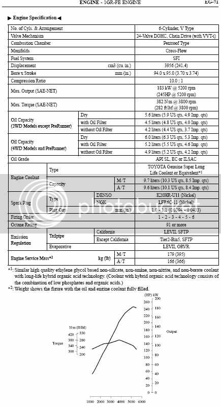

The weight is 399lbs. (all #GR-FSE v6's weigh between 392-399lbs)

They make great power to weight ratios tho. The 2gr-fse is currently around .76 bhp per lb while the 2gr-fe Camry engine is only 359lbs, is pysically much smaller, and has .75bhp per lb.
