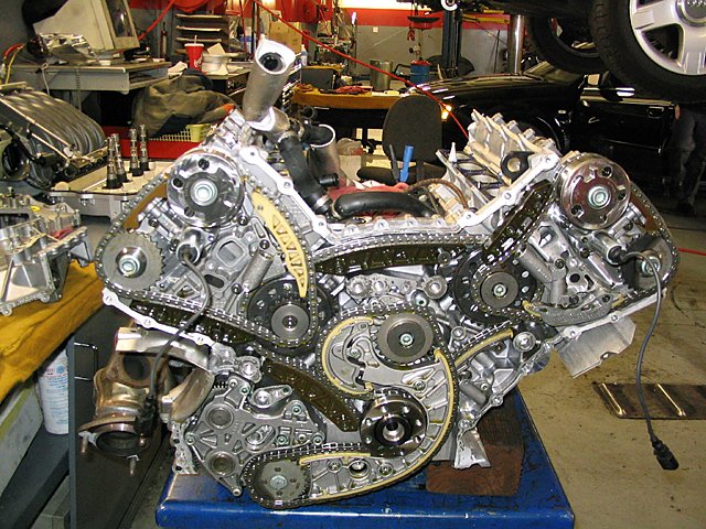

There is huge range of V8's available ranging from AUDI to Toyota, some with small size on their side others with bullet proof reliability.

I was curious about Euro engines as they seem quite compact and have plenty of grunt. Not sure my wife would like me stealing her SLK55 engine?
Recently helped mate to convert porsche cayenne to 3uz. Original EURO engine has aluminum cylinders with ceramic coating, which is easily etched by less than perfect fuel. As a result, whole car is sold for dirt cheap
Euro engines with warranty are great....otherwise not so much.

Euro engines = too much tech, overly complicated, not reliable, no aftermarket
