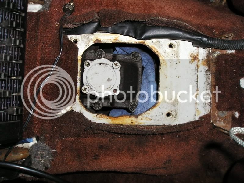

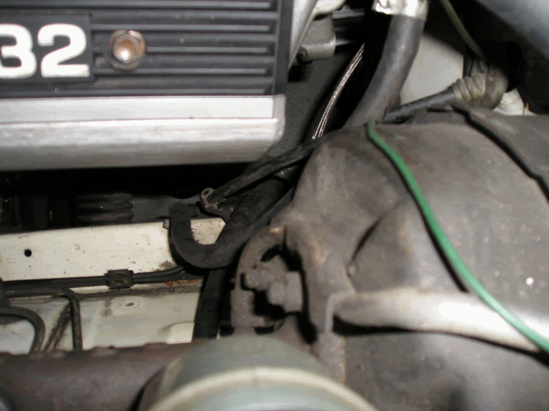

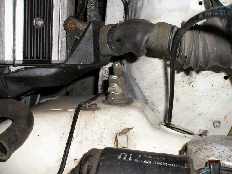

No no. It's one or the other
HEre are some pics of where it sit's without doing any modification to the MA6X Chassis. I'm hoping to do better, but there's no miracle.
You either have to make the driveshaft longer or make the engine go back. Getting a custom bellhousing like A1 turbo model would probably help the clearance issue, but I don't have experience other than home maid sandwich plate.
i was looking at the drive shaft today and there is a bolted joint right at the bearing carrier.
If i make a 2" doughnut *with the same four bolt pattern* and an offset bracket... (im pulling the 2" number out of my ars... im not sure exactly how far forward i can go, shifter location and clearance between sway bar and oil pan will prolly be the make or break).... looks like your darn close to as far forward as you can go with the shifter hu?
I guess i dont know till i see it eh?
