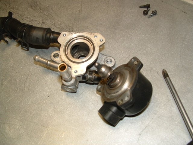

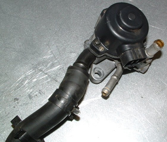

Anyone with SC400 having idle problem? I have in my LS400 recently and got a 95 SC400 ISC from JamesN. I found out the SC400 (at least 95) is slightly different from the LS400. The LS400 is a two parts. ISC and the housing. A very good article from Planetsoarer on repairing the ISC. However, in the SC400 the isc is NOT repairable. The SC400 ISC is one unit and unable to seperate the housing from the ISC. This is just a FYI. Perhaps i can take some pics and compare them for you guys. My suggestion would be if you see a ISC from a LS400. Buy it and keep it. They are hot part to get.

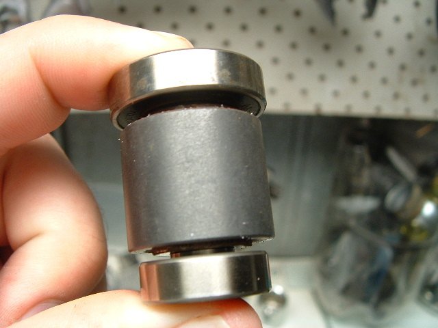

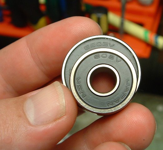

I called around and found the bearings stated by Peter Scott. The bearing part number 608V is about $3.59 USD and the 6902V (61902V is more universal and its the same as the 6902V) is only $4.10 USD. I will post a video on this tutorial soon. Pictures courtesy of www.planetsoarer.com

Second, I have looked around online... where did you manage to find those bearings? I have been unable to locate them.
