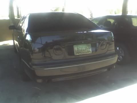

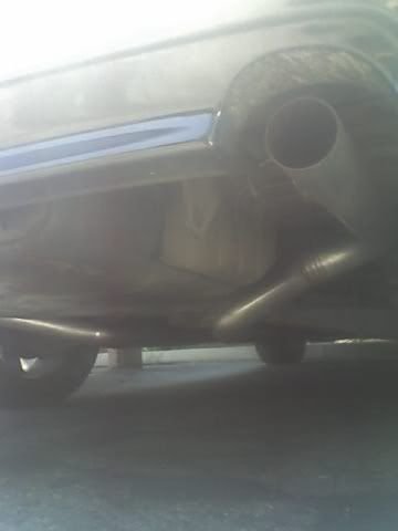

On my old 98 gs400 i went with a straight piped cat back exhaust. No mufflers or resonators. However... I lost ALOT of torque. It was almost to the point where i thought i wouldnt be able to squeel my tires from a stop. It was depressing. But i loved the sound! Everyone said it sounded like a race car. It was anywhere between 2.25 or 2.5 inch piping i forgot cause this was 4 years ago. I am running no mufflers on my gs430 and tomarrow i am getting the resonators removed. How can i avoid the power loss. I am flat broke cause i just bought a vortech v2 and cant afford mufflers. And i dont want to get cheap ones i want to get borla xr1 race mufflers sometime in the future. I also plan on installing an apexi neo on the car for the supercharger install. Im not someone who is super experienced with building engines but i love loud fast cars. So i really dont know why i would loose power from straight pipes. I know back pressure plays a part but i know someone who had a 3 inch straight piped cat bak on his gs4 and didnt lose any power. Also would it sound wierd if i removed just one of my resonators? I need your guyss help
Old exhaust
