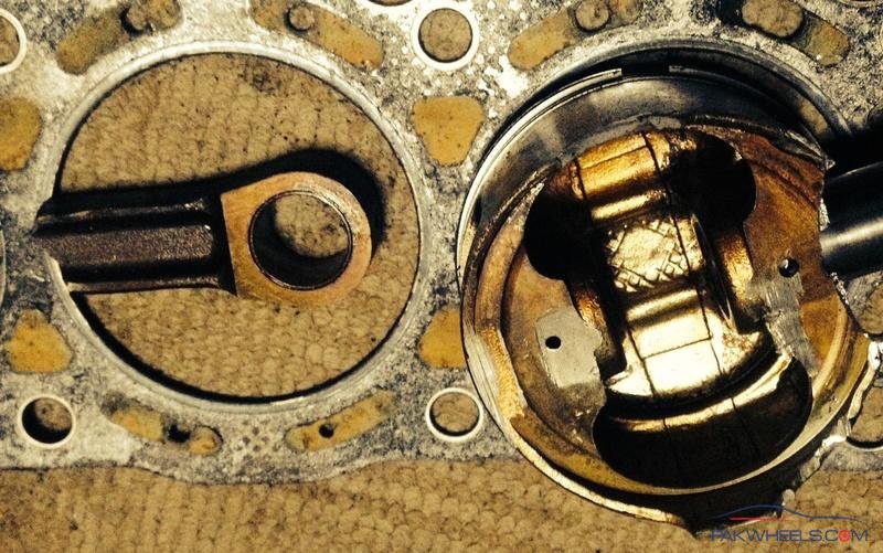

Well, we run a 1UZ on a Land Cruiser FJ40 for desert racing with 4x4 and locked rear diffs. Recently, after 4 successful rally raid completions on our fifth heavy duty race we managed to finally kill the 1UZ. About 10 kms from the finish line, we heard some crackling sounds from the engine and lost oil pressure and all power within a matter of seconds. The engine would start initially but was unable to move the car on the sandy track. The left cam seal was leaking oil and though we topped up the oil, the crank jammed up soon afterwards. Mainly my fault though because I was running it in second gear essentially all the way and rev cutting it a lot by the end. It was a great run for this 1UZ but it had to end somehow

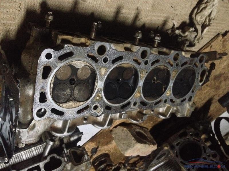

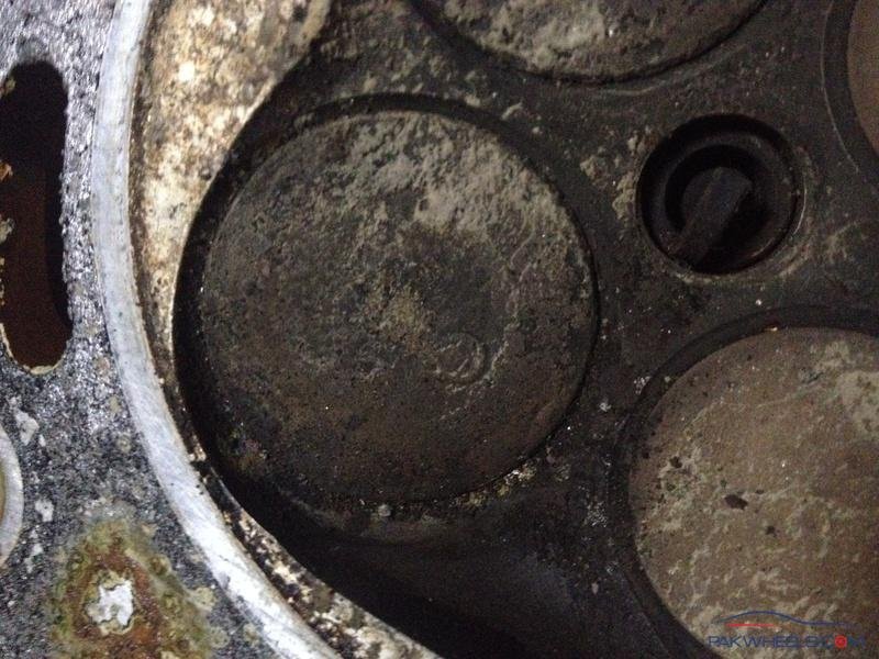

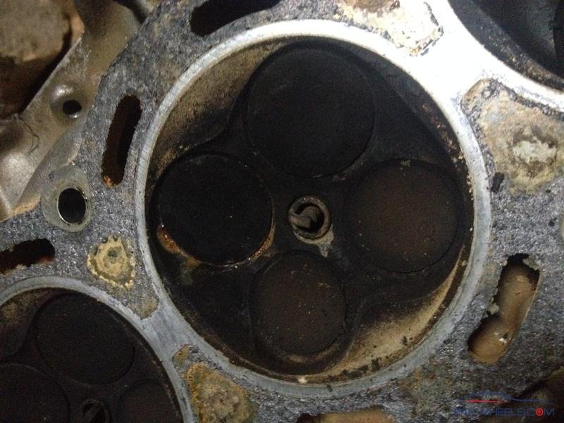

We are still in the process of analysis. Lifted cam covers to find that while the right bank seemed well lubricated the left bank cover was kinda dry and dark. Looking for clues as to what may have gone wrong and essentially what would be the best solution as we slowly dig in deeper...
