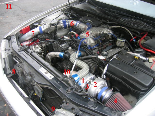

If I could offer one word of advice I would say these three words... INTERCOOLER INTERCOOLER INTERCOOLER, and not some small 40mm thick piece of ****. Have a look at how the skylines GTR's and GTS-T's, Mitsubishi EVO's and WRX's do their front mount IC's. Don't worry about piping lengths for the intercooler connections. These DON'T cause excessive lag provided you've matched your turbo's properly. Look at Anthony's Twin 1uzfe setup. Its close on 2 meters of piping from turbo to throttle body and it makes boost that quickly that the car can't get traction at all, in any gear for that matter.

Don't get some sort of core based on a truck intercooler either. They are inefficent and are not designed with perforance in mind. Anthony's core is 4" thick and the temp drop on it from compressor output to throttle body is amazing. Hot on one pipe and cold on the other. A noticable 30 degree+ drop. The more efficent your charge cooler the more boost you can run, the more ignition advance you can run and the more RELIABLE HP you will get.
