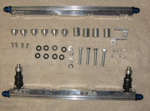

I would suggest 9.0:1 compression. Secondly which supra injectors came in 550 cc/min? If Supra MKIV they are side feed and would not work. Possible MKIII injectors but they are low impendence. I would suggest you use Mazda Rx7 550 cc high impedance. They are plug and play right into the stock fuel rails. Lastly, if you are going to use upgraded fuel rails like the Wolfkatz Engineering Fuel Rails, then you can just use domestic injectors.
