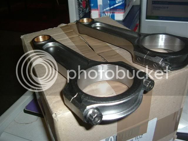

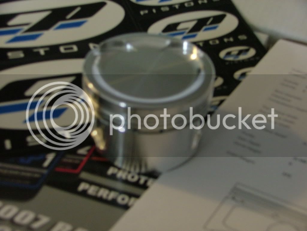

Rebuilt or another engine built with forged low compression pistons and forged rods..

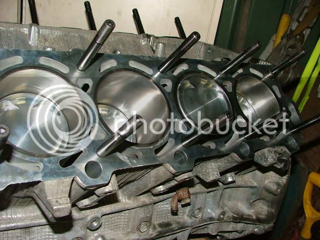

Steel Cometic or MLS heads gaskets and head stud conversion is best to help prevent head lifting on high boost levels..

The early 1UZ's had better rods than latter model...
