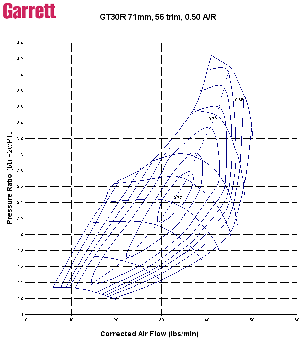

Do u have a compressor map for the HKS3037 Would this help a little www.lextreme.com/GT.html
Saved........ Lex, i am still relatively new at this...... i know a little about alot of things..... I am very thankful to have a forum like this though........ As we all should be.... Thanks again for everything.........

The 3037's would work fine on the 1uz. You won't get the best response since they are larger turbos but they make enough power to keep you happy.
I have a feeling your friend switched back to the 2835's due to lag issues with the 3037's since the Supra is a 3 liter engine.
With a 4 liter engine I imagine the lag won't be too bad. Just make sure to build up the 1uz to be able to handle higher boost.
