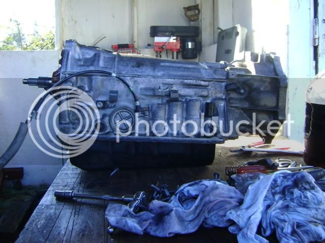

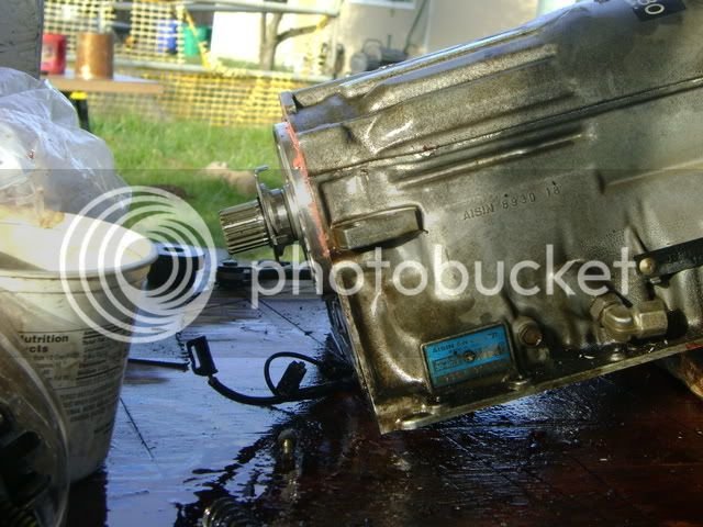

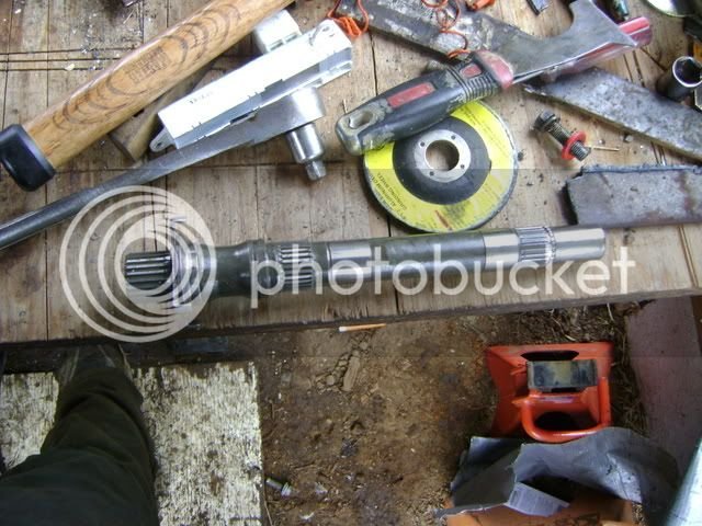

This is a lexus auto with a 2003 3.4 liter V6 tundra output. I bought the tundra tranny for the tail housing and the deeper pan. When I pulled it apart I found that the output had the same 4 prong rotor that the lexus had. The spacing was the same as the lexus so I decided to use the tundra output instead of cutting down the lexus.
I mainly did this because of the rotor as it seemed getting the lexus one to work would be a pain. Swaping the outputs is not that hard if you take your time and keep everything in order.
In the US the 90's 3.4 liter trannys came with a two prong speed sensor rotor and I'm not sure when they switched over to the 4 prong. If you could find one of these trannys you could swap the input, oilpump, And torque converter from the lexus onto it. I bought mine for cheap as a core so I used the lexus tranny even though it was a little more work.
2003 tundra 3.4 V6. Other newer 3.4s are probably the same.
lexus tranny with tundra output installed.

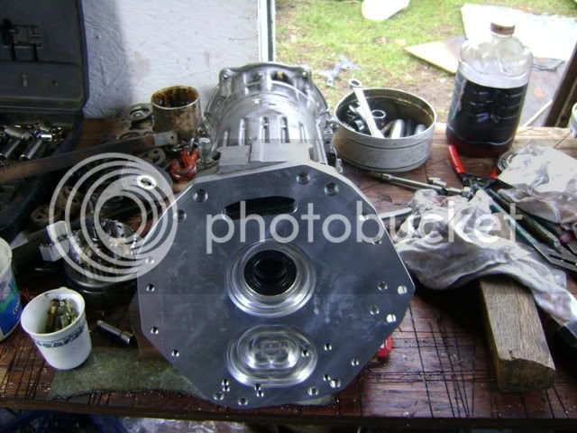

Lexus tranny with tundra tailhousing and deeper pan.
Inchworm auto tranny to gear driven transfercase adapter.

the 4wd output shafts have different oiling holes to feed the transfer bearing ... its quite funny .. in all the adaptions ive seen done .. noone has ever picked up on that
i've cut down an lexus output shaft to fit the transfer case, does this
effect the oiling of the trasfer case bearing? if so how crutial is it?
